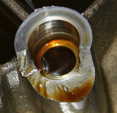

Theres a defect on some of the older models, where part of the casing that holds the starter gear cracks. And you hear the starter free of the load, just spins. This is what I'm affraid of. I just cant understand why it broke now with a half charged battery. Possibly too cold?

I think you're okay, Tom. The cracked crankcase problem had occurred for some (most?) when ya get a huge backfire at the time of starting. In your case it sounds more like a low battery. Have you put a voltmeter on the battery just to see?
Meanwhile, here's a long thread on the topic of cracked cases.
http://www.bonnevilleamerica.com/forums/...part=1&vc=1

I seen this pic in the other thread. It scared me like those STD pictures in health class..haha
