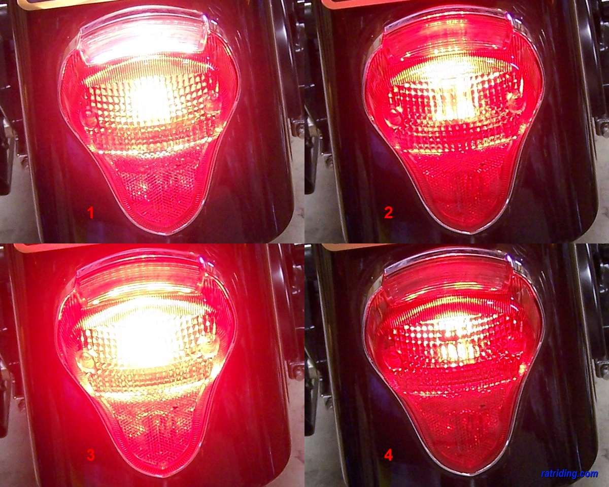

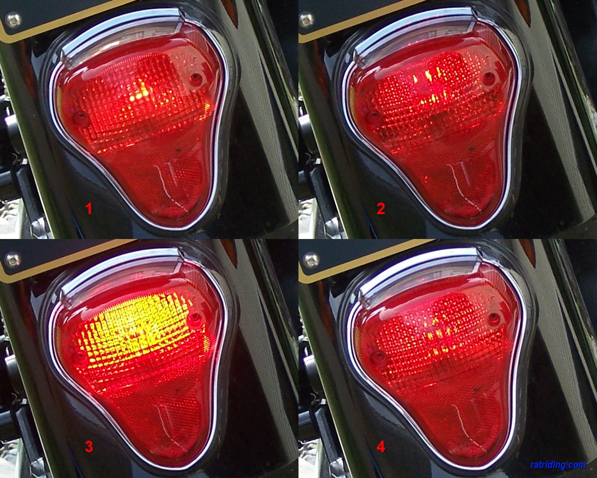

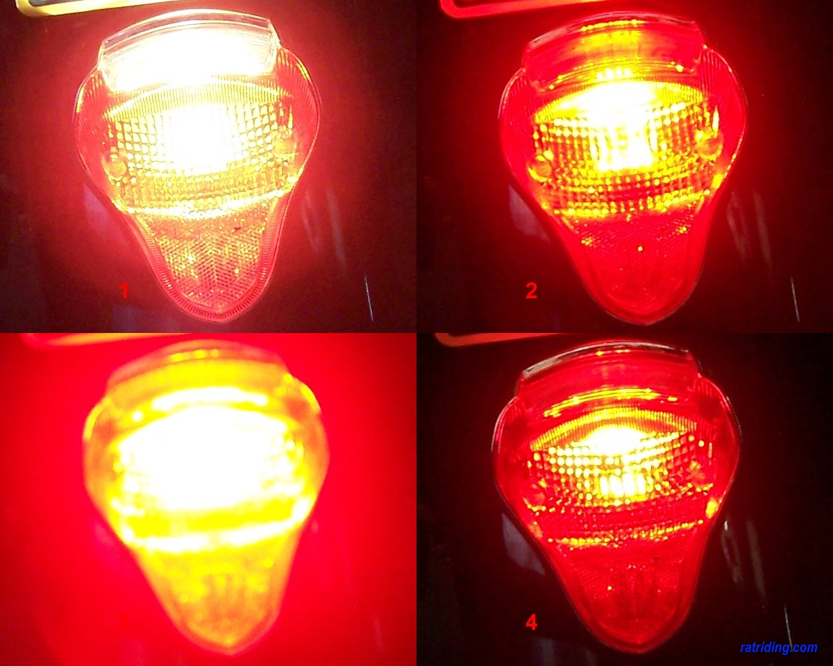

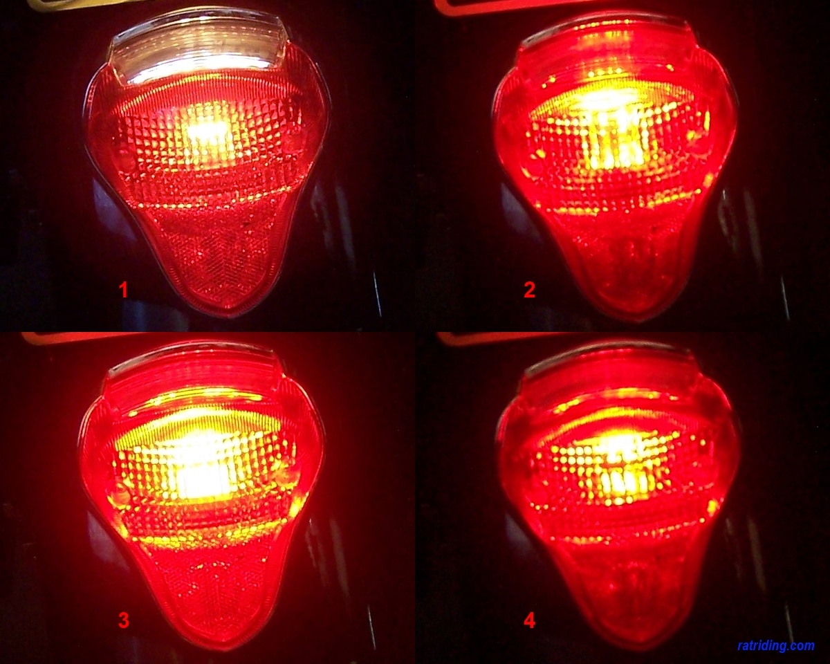

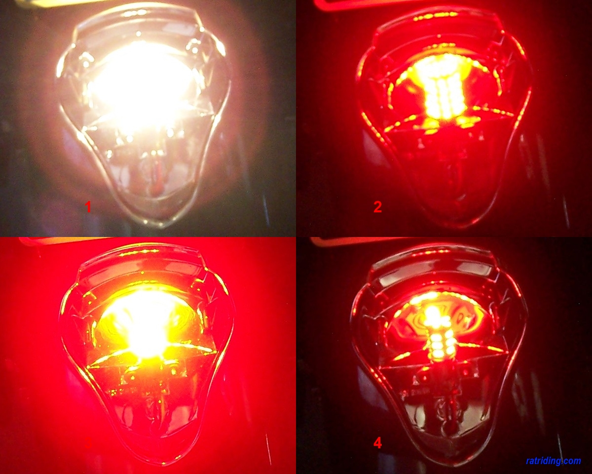

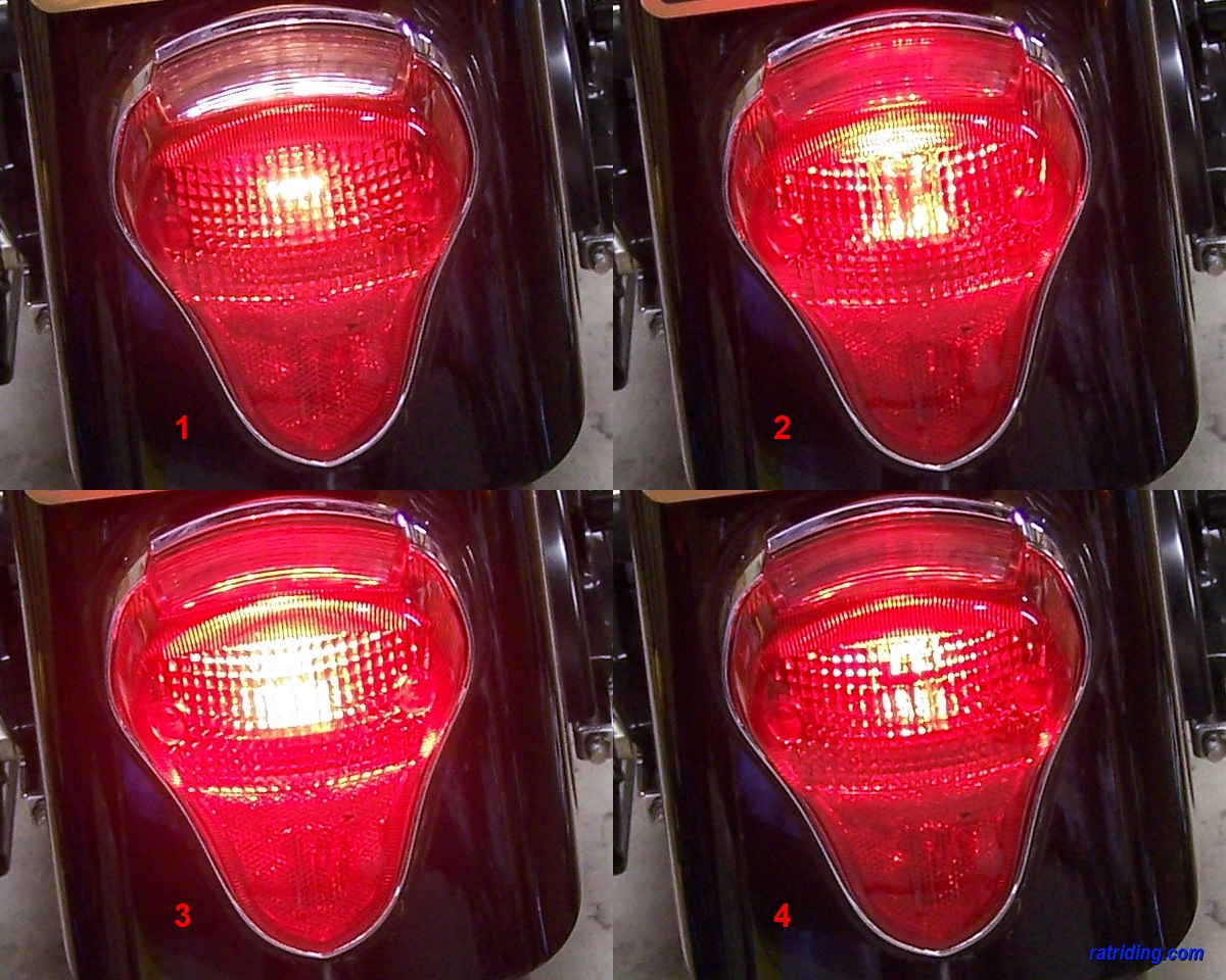

Today I compared several tail lamps for possible use with my '09 Speedmaster. I am posting the results and will let you decide which lamp is best for you.
Please note that a caption follows each photo.
Above are the four lamps I tested:
  • 1. Factory-installed 1157-style incandescent (free with purchase of motorcycle)
  • 2. Red 63 LED from eBay vendor "ushd" ($2.99 US + shipping)
  • 3. Red 45 SMD LED from superbrightleds.com ($24.95 US each + shipping)
  • 4. Red 42 SMD LED from eBay vendor "superb_lights" ($16.99 US/pair + shipping)
Here is the tail light turned off indoors.
Here is the tail light illuminated indoors.
Here is the tail light illuminated indoors with the building lights turned off.
Here is the brake light illuminated indoors.
Here is the brake light illuminated indoors with the building lights turned off.
Here is the brake light illuminated indoors with no lens cover and the building lights turned off.

looks like #3 is the winner... of course.. mo money .. lol.. great test .thanks for the efforts..
which one did you keep in the tail BTW ???

#3 looks the best
Thanks for the survey

#3 looks best to me too!

My vote: #3. I too wonder what that would look like with the red illumination on the plate with a red LED.

None of the LED seem to illuminate the license plate much... If I were to swap, I would go with number 2, the price is much more reasonable, it is better than stock, maybe not as bright as #3, but for a $20 difference I could live with it. But realistically, if I needed one, I would go to the nearest parts store and get an 1157 bulb and be done with it.

Thanks CCI for taking the time to purchase the lamps and make the comparison. #3 for me also.

You outdid yourself. Very thorough and helpful guide... thank you very much!! # 3 for me too!!

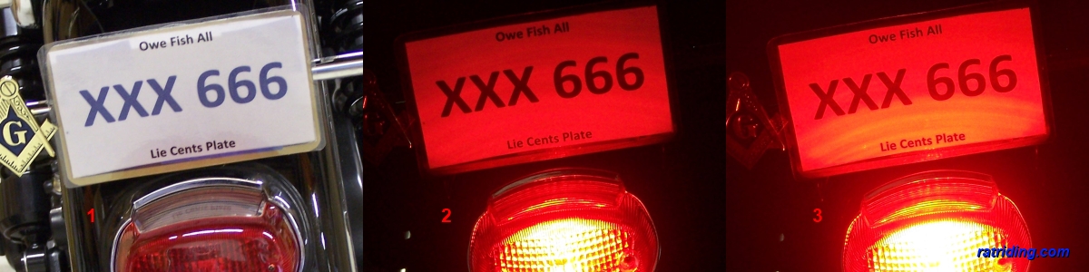

Here's a photo of an "official license plate", under the following conditions:
  • 1. Tail light turned off indoors
  • 2. Tail light illuminated indoors with the building lights turned off
  • 3. Brake light illuminated indoors with the building lights turned off
Yes, this is lamp #3.

I wonder if any city/state/county/province have laws specifying the color of light illuminating the license plate? I think most of them give a distance at which it must be readable at night.

Only problem I see (depends on your state law) but the License plate lamp must be white in some states...
From Texas Transpertation code (see f)
Sec. 547.322. TAILLAMPS REQUIRED. (a) Except as provided by Subsection (b), a motor vehicle, trailer, semitrailer, pole trailer, or vehicle that is towed at the end of a combination of vehicles shall be equipped with at least two taillamps.
(b) A passenger car or truck that was manufactured or assembled before the model year 1960 shall be equipped with at least one taillamp.
(c) Taillamps shall be mounted on the rear of the vehicle:
(1) at a height from 15 to 72 inches; and
(2) at the same level and spaced as widely apart as practicable if a vehicle is equipped with more than one lamp.
(d) A taillamp shall emit a red light plainly visible at a distance of 1,000 feet from the rear of the vehicle.
(e) If vehicles are traveling in combination, only the taillamps on the rearmost vehicle are required to emit a light for the distance specified in Subsection (d).
(f) A taillamp or a separate lamp shall be constructed and mounted to emit a white light that:
(1) illuminates the rear license plate; and
(2) makes the plate clearly legible at a distance of 50 feet from the rear.
(g) A taillamp, including a separate lamp used to illuminate a rear license plate, must emit a light when a headlamp or auxiliary driving lamp is lighted.
Acts 1995, 74th Leg., ch. 165, Sec. 1, eff. Sept. 1, 1995.

According to the two sources (knowledgable & reliale but not definitively authorities) Kansas requires the license plate be illuminated with a white light. So... I'll be blocking off the taillight from illuminating the license plate and adding a separate light for that for the VStar - I'll see how that goes before I start splicing wires on the America.
Thanks for the great information!
