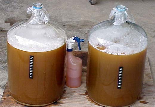

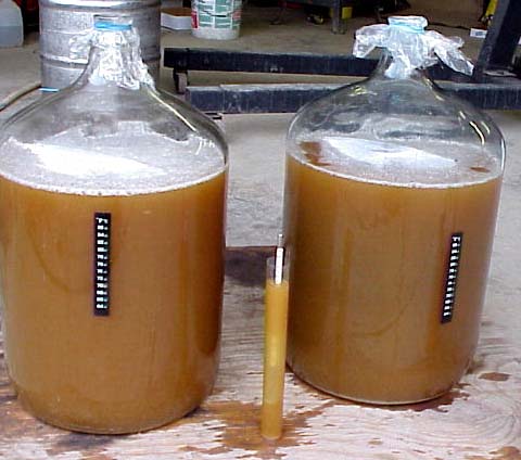

Here is the aerated wort along with a sample we took for our hydrometer. I believe the gravity on this batch was around 1.058. Taking an Original Gravity reading is very important so you can tell when the fermentation is completed.Here we are, two nice full carboys, all aerated and full of hungry yeasties. With our methods this will be at very active fermentation within 6 hours. We will put the carboys into some large plastic muck buckets with some water in order to maintain a very steady 65-72°F temperature. This is the recommended temperature for the strain of yeast we used. In about a week we will rack them over to secondary fermentors, 5 gallon glass carboys, for about another 10 days. After that, keg them and drink 'em up.
