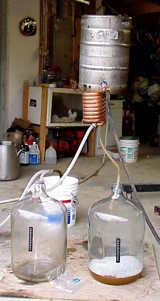

Here's the whole setup in action. You will notice that we also use a motor hoist in order to raise the VERY HOT keg enough to let gravity do the work of flowing the wort. We place the carboys on a piece of plywood to keep them from coming in contact with the concrete garage floor. Concrete + Glass + homebrew = emergency room visit, not nice. Use caution with all glass!! We turn the tap water on at a fairly slow to medium rate which allows for the exiting wort to be at approximately 70°F as it goes into the carboys. Also note that we use 6.5 gallon carboys for primary fermentors. |
