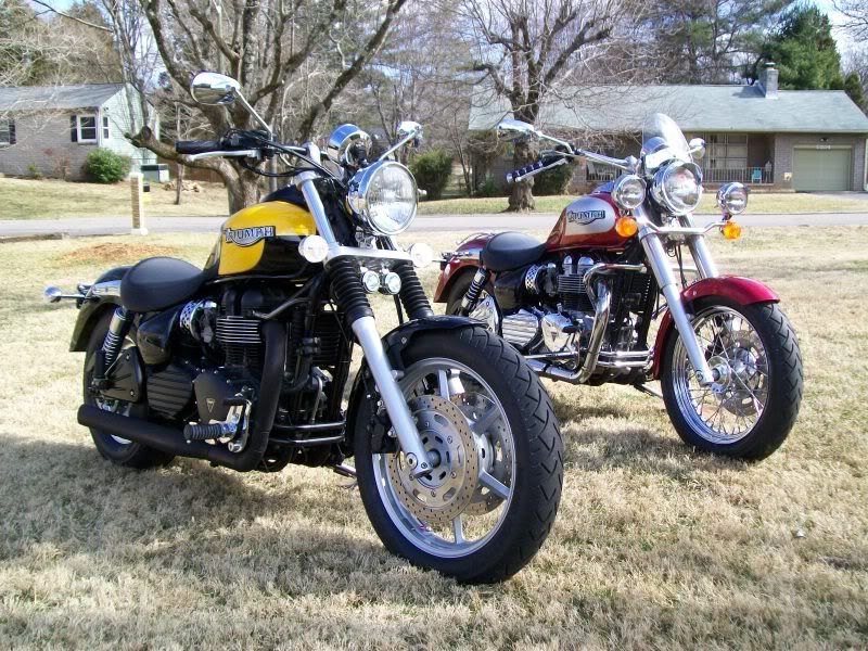

tdragger #574902 12/21/2015 4:30 PM
Wade Offline OP
Oooh yeah those look great ! Mike, those two bikes look just like our fleet, the yellow and black Speedy and Lola.
And I will keep you posted Edward B Turner the Third !
