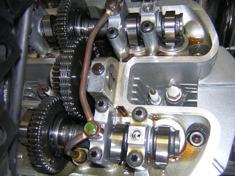

Valve Adjustments
bennybmn #43834 04/05/2006 10:45 AM
Valve Adjustments:
Yamaha Shims for the V-Max are direct replacements for Triumph shims.
SOB shims
25mm Used in Honda ('79--'83 4-cylinder CB750, 900, 1000, and 1100 series engines, and 1050 CBX 6-cylinder engines, and others), Yamaha (V-Max, and the FJ1100/1200 series), Triumph 3- and 4-cylinder liquid-cooled motorcycle engines, and older Toyota car engines.

Re: cam cap bolts
moe #43855 11/21/2012 2:30 PM
McMaster-Carr sells the new and improved cam cap bolts (as opposed to the pan head torx on older models). Pack of 25 for $6.60. Shipping for two packs to Central Florida was $5.45.
The image immediately below is for illustration purposes only to show the old style bolts.
McMaster-Carr:
Price per pack of 25 (twenty five bolts): $6.60
Part number: 91310A342
Description: Class 10.9 Black Fnsh STL Hex Head Cap Screw M6 Size, 40mm Length, 1mm Pitch, Fully Threaded, packs of 25
Website
Compare at the Bike Bandit:
Price per bolt: $1.80
Part number: 2126219
Description: SCREW,PAN/HD,TX,M6*1*40,SLV
