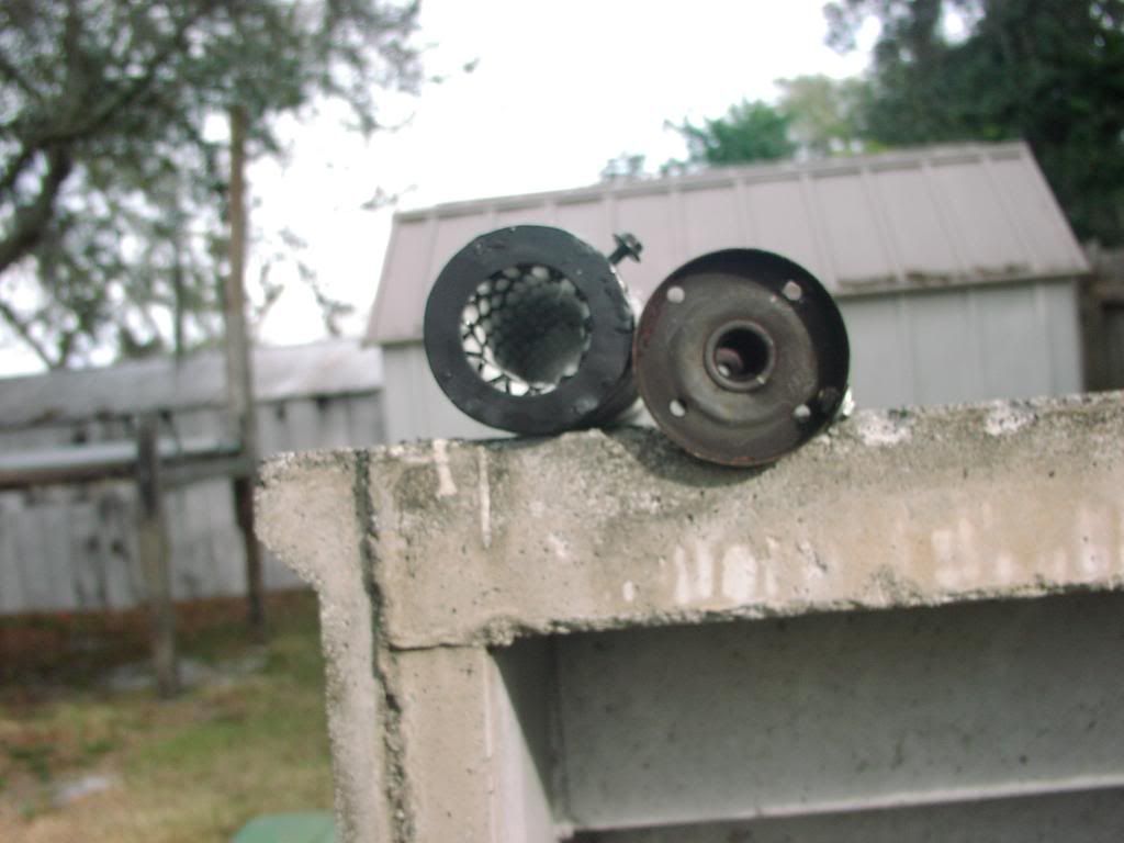

I built mine by using a square of expanded metal, bought at Home Depot, rolled it into a 1 1/2" tube, and wrapped with packing material from J.C.W. Brazed a round end piece on it, and viola! Here's a pic of my baffles next to the stock baffles (from the J.C.W. pipes) Their modeled after the FMF Powercore mufflers on my Yamaha's.    Total cost didn't hit $20.

 Re: Crossover pipe
Posts: 3,099
Posts: 3,099 |
Used to call them "glass-pacs" Bet they sound great! Uncle Charlie

 Re: Crossover pipe
Posts: 3,937 |
Robert what oil are you using in your mufflers
Frank, Did you just edit your post to add the word "oil" to your question!??
That whole long post about my baffles, and how I made them, was in response to what I THOUGHT your post asked, I thought it asked "Robert, what are you using in your mufflers?"
Well, just ignore it now.
