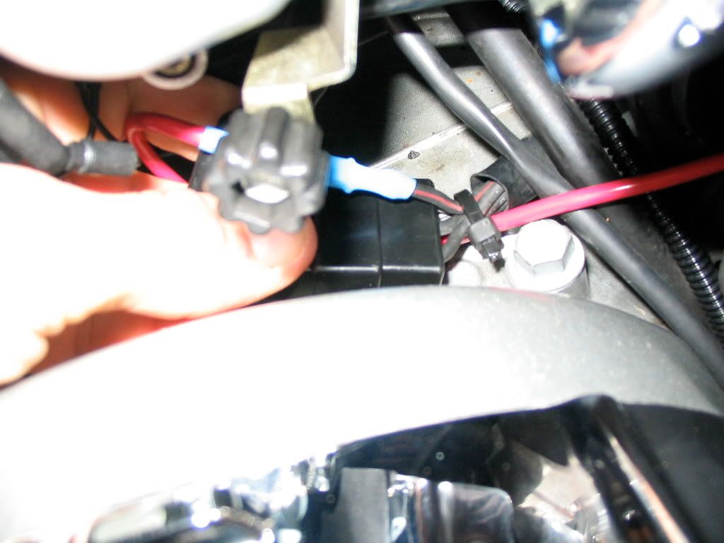

Looking in from the left side under the carbs...
In this pic, the wire you want to splice into is the red/black one coming out of the rectifier. Pull the wire out of the plastic connector, and then take a heavier gauge wire (10 or 12), and run it directly to the positive battery post. You will need a couple spade connectors, some heat shrink tubing, and a connector for the battery end of the wire. It's that simple. Wire out of the rectifier, bypass the long skinny wire in the stock harness with a shorter heavier wire directly to the battery.

With Roadworthy's picture and description, I did the rewire this afternoon. A few notes:
There isn't much slack in that red/black wire. I pulled the rectifier mounting fasteners (10 mm, 2) and was able to pull out another inch or so of wire to work with. Even so, there still isn't much. It was tough wrapping the OEM wire to the new lead and getting it soldered correctly. If I have issues later, I'll suspect that solder joint.
I did the solder on the regulator side from the right side of the bike. Roadworthy's picture is from the right side.
Fired the bike up and got a steady 14.3v at the battery. I think with my new battery last near, I was only getting around 13.4v at the battery with the bike running.
One thing that tells me I made a postive impact for sure, is that my horn is at full volume with the bike just idling. Previously, my horn always sounded pretty weak.
Regulator Side:
Battery Side:

Al, you did it a bit differently than I did, I pulled the spade connector out of the plastic end of the rectifier wires and joined them with a spade connector and shrink tube. Battery side is the same though. Glad you got the bike charging again where it should be.
My pic is from the left side, as you sit on the bike. You can see the idle adjustment knob under the carb.

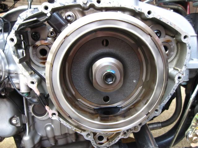

I've checked for damaged wiring or connectors but now I'll pull the cover to see if there is damaged wires there. If not my problem is unquestionably the stator.
Re: Electrical charging issues...
Keith #379449 03/16/2010 4:59 PM
Keith,
If you're real careful you can pull the cover while the bike is on the side-stand and only lose a tablespoon of oil on the header. If you're thinking of doing it on a lift you'd better drain the sump. And, don't let the strength of the rotor magnet throw you off, it'll give a good tug on the side cover while you're removing it. A gentle tap on the four ears (each quadrant of the cover) while assist you in the removal operation.

The stator is off the bike now and it was DEFINITELY at fault. But the question is... what would make it fry like it did?
Another question... why is there oil in there? Must be normal or Ed wouldn't have mentioned it being there, but why?
Fried stator (look to the lower left)
Oil in there
Oh yeah... Greg, I will be sure to take those new reading as soon as I get Freedom's old stator delivered and installed.

Keith #379452 03/16/2010 8:02 PM
Hey Keith,
Glad you found the culprit. Man, you are now certified as a Triumph charging system expert. Glad you posted your find. The resistance readings really pointed to a grounded/shorted coil.
I've included a link to RM Stator in Quebec that repairs stators and regulators as well as supplies CDI units for the Bonny (360 engines, not ours). More expensive than Pinwall but an option none the less. RM Stator
