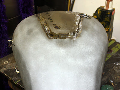

A significant bit of progress today but I feel bad. I was watching football with my girlfriend all day while my buddy was working in the shop. Unfortunately I just have a fuzzy phone camera picture.
http://twitpic.com/zo09o
Next time he'll weld in the sight gauge bungs and the filler bung. There are a couple high spots on the large patch that need further shrinking. Then we'll seal the inside and start a skim coat of mud on the top. It's gonna be AWESOME.

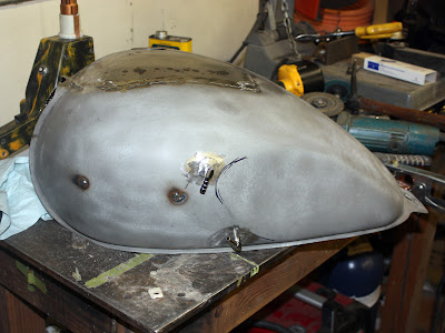

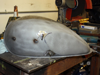

A little more progress today, but very significant progress...
The little dots are shrinkage marks from that boxy gun-like device in the background. He wants to do a little more of that to minimize the filler needed. That gun also spot-welds rivets onto metal for the purpose of pulling dents and will be used on a small dent to the right of the gas filler.
Then we seal it, test it for leaks and start the bodywork and paint.

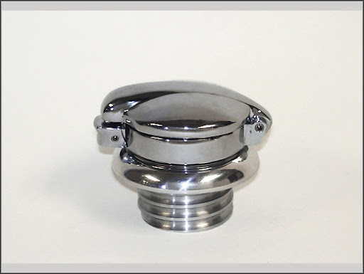

That gascap of yours is a beauty, cant wait to se all the pieces come together on that tank
