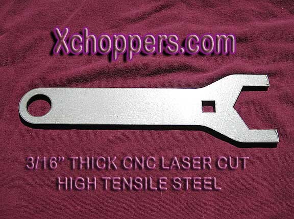

I couldn't get the two headset nuts to adjust without the special narrow wrench. So, I cut one out of a piece of steel, which worked fine (and suggested earlier in the thread).

Xchoppers posted they now make a wrench for the headset adjustment that has the square hole to put on a torque wrench. Only $10, but $20 shipped. Still beats the factory wrench ($50/set?)
http://xchoppers.com/product_info.php?products_id=1924
