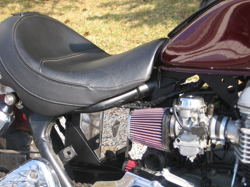

brokenfixed #327531 12/02/2009 1:47 PM
Posts: 311
Posts: 311
I'm looking for somewhere to locate the breather filter and was wondering what the two bolts either side of the serial number stamping just behind the George Foreman Grill do. There the ones just in front of the filter in this pic.
Will the bottom fall out of my world if I take one out and fix a bracket to it and then replace.
I know it seems a daft question but will save me searching all over the place.
Cheers
Chris
Re: 3 days wasted on airbox mod
oldgimmer #327532 12/02/2009 3:15 PM
I just used that small black bracket guard that fits under the sprocket cover. Bolted it in the upper portion and connected to that. You can sorta see it in this pic
brokenfixed #327533 12/02/2009 10:18 PM
Dang, that's a good idea.
FriarJohn #327534 12/03/2009 10:22 AM
one of many for me...haha
I think it was a tight fit, but it works.

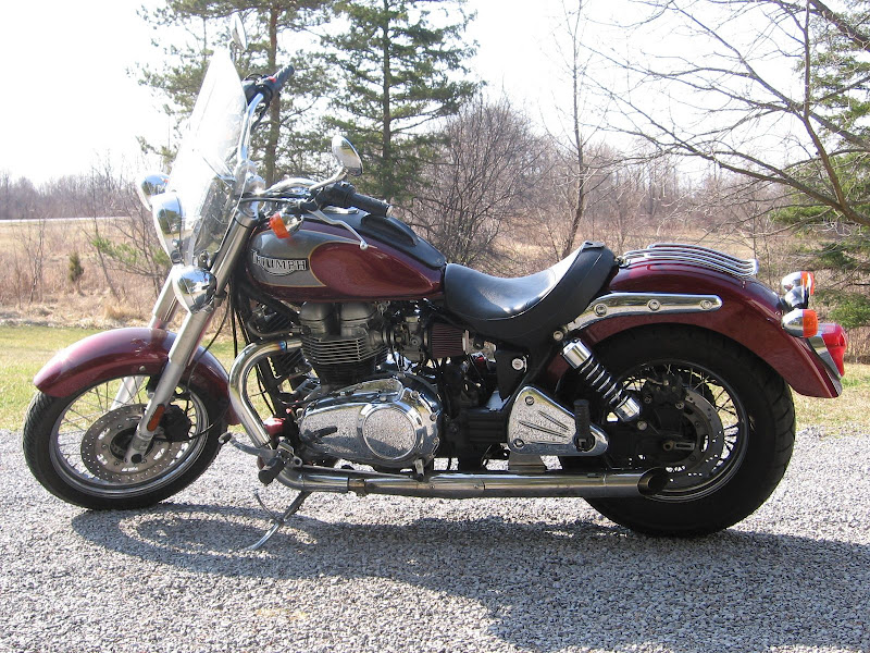

roadworthy #327540 03/21/2010 11:18 PM
Posts: 525
Posts: 525
I’ve been meaning to post these pics for a week or so. I picked up Tom's (Brokenfixed) battery relocation kit about 2 weeks ago. If you want to do this mod, but are like me and don’t have the technical knowhow (or the tools) to build your own mounting plate, this is definitely the way to go. Very fast turnaround, great price, great fit and finish and I love the end result. I had some questions along the way, and Tom got back to me quickly with answers and advice.
Anyways, here are a few pics of my bike after the relocation. I was toying with the idea of getting the whole box chromed, since I already had the chrome cover. But I needed a new set of tires for the truck much more than I needed chrome. I took my old battery box and cut off the mounting plate for the fuse box and ignition and mounted them to the stock location. Because of that, it’s not quite as minimalist as some of the installs I’ve seen, but I like it. I still need to mount the carb brace this week, but then its done (except for the re-jetting)
The_Insane_Viking #327541 03/22/2010 7:30 AM
Hey Carl, that turned out really good with the ignition/fuse box added on the side. Looks like you gotta cut those side cover tabs off though..haha People get nervous on that one.
