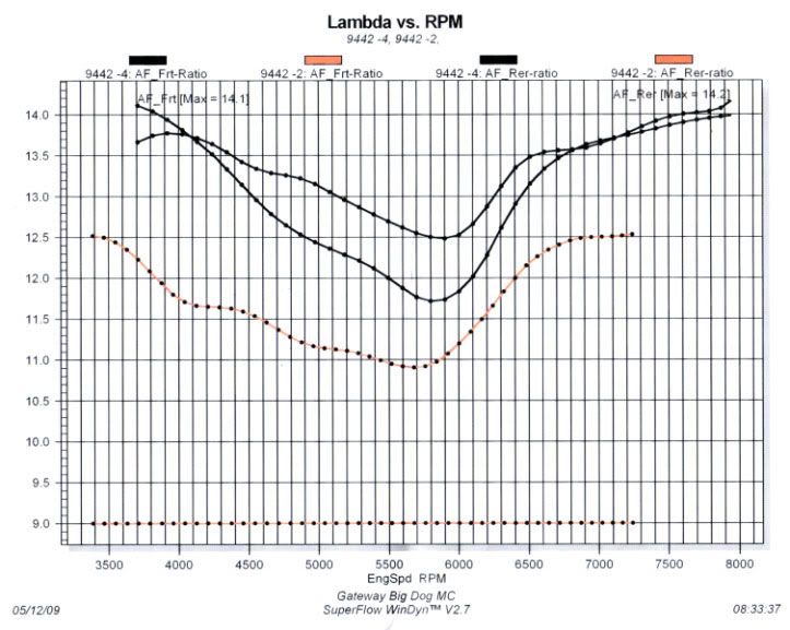

What was your AF ratio? You said you needed to tweak it.
Did the carbs come pre-jetted by Fred? Too rich, too lean?
Re: 8HP!!
Zmilin #326602 05/12/2009 1:00 PM
Posts: 10,721
Posts: 10,721
I used the same jet setup as my stock carbs had 45/155 with 2 shims under the needles. I need to drop the needle one shim, and maybe go one size bigger on my main. I plan on talking to my Triumph dealer/ mechanic this afternoon, show him the charts, and see what he suggests. I ran this with the stock spring in, I will be going back to the lighter Kawasaki spring. My biggest problem was that it was rich in my cruising range, at about 4000 rpm I was at like 11, 11.5, so hopefully the spring lets the slide be open a touch more and drop the needle 1 shim to fix that. I'm lean up top too, so maybe a 157 or 160 is in order. After I get some tech support, I'll post what was recommended.

Just out of curiosity, who else is making max torque at the rev limiter? I thought it would have dropped off, but it was still going up when it hit the limit.
here is my air/fuel mix, same jet set up as what I had before, just way more lean now because of all the extra air
I would like to get around 13 all the way across.... right now at cruising speed (about 4000 rpm) its really rich, down near 11 so I need to get that corrected too.

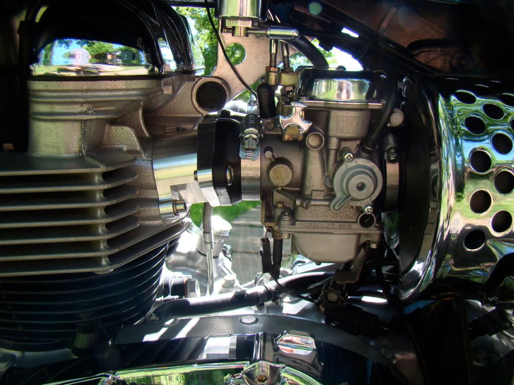

The Intakes Have Arrived
roadworthy #326618 05/20/2009 12:30 PM
Posts: 10,721
Posts: 10,721
And here are a couple pics. The fit is perfect, they are solid, no more carb wobble at idle. You can see where Fred tapered the cut on the boot side of the manifold from top to bottom to match the stock 17 degree angle. These should work just fine with the stock air box, mine is removed. Since there are no more manifold rubbers, you could get away with running pods with no carb support, they are in there good. I'm going to take it for a spin in a while and see what the difference is. The dyno should tell more than my butt though.

roadworthy #326623 05/20/2009 1:25 PM
Posts: 1,440
Posts: 1,440
Those look really good! What are the black flanges between the manifolds and the carb bodies? Are they painted aluminum?
Re: The Intakes Have Arrived
Lazyrider #326624 05/20/2009 1:41 PM
I was assuming a harder rubber if theyre being sealed with a hose clamp around the carb output.
Seems like you still would want a carb brace on there though just to keep the weight off that hose clamp joint?..no?
I mean Ive ridden around for a while before I realised I needed a carb brace that the previous owner never put on. So i know its not a big deal really. Just seems like the brace wasnt in the way or hurting anything...no?
brokenfixed #326625 05/20/2009 1:55 PM
Posts: 10,721
Posts: 10,721
Yeah, they are rubber, but these are a lot more solid than the stock rubber manifolds. My carbs are still braced, but it probably doesn't need it. Even without the brace, you can put some pressure on the carbs before they will move.
roadworthy #326626 05/20/2009 2:26 PM
Joined: Apr 2009
Posts: 639
Joined: Apr 2009
Posts: 639
Looks like really good work!! What is the principal behind the intakes. I've been following along and see how the carb work changed the fuel flow, same idea on the intakes? 8 hp is a sweet gain for $350. How much were the intakes?
Looks great, Dave. Like the choke knob too!
08America #326627 05/20/2009 4:54 PM
Posts: 10,721
Posts: 10,721
Basically, the stock intake manifolds are a choke point on our fuel delivery system. I don't know if overall velocity is down, but flow is up. I'm not all technical savvy about these, I can only go by hard numbers on a dyno machine. I'm not sure how much the intakes were, I'll look it up and let you know. Fred ported my stock manifolds, they are in the classifieds right now, I think he said he would do that for people that don't buy the intakes for 70-80 bucks, please don't quote me on that, we talk about a lot of things... anyway, my ported stock ones are for sale.
B02S4 #326631 05/20/2009 8:23 PM
Posts: 10,721
Posts: 10,721
I didn't have the ported stock manifolds on during my last dyno, so I think there will be an improvement in power.
