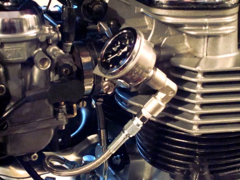

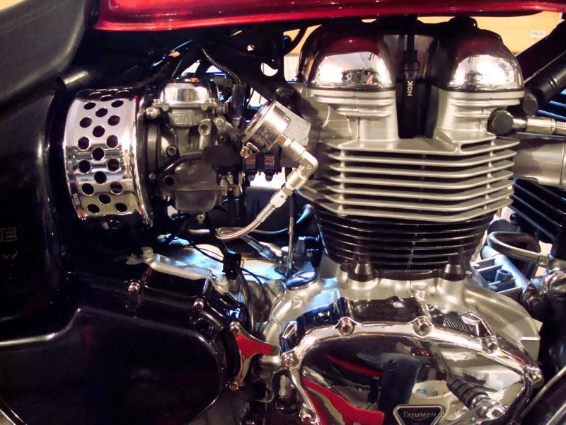

So I thought I needed an oil pressure gauge with the BB and all. Looked at all the ones out there and got ideas. Didn't quite like the ones I saw, so I made up my own mockup:
Bought a gauge that coud take 100PSI, an 8" brake line an3, an 1/8 female elbow and an adapter an3-1/8. Got some help from Ian (thanks buddy) and then good ol' Brent (thanks to you as well) could sell me a double banjo bolt that actually worked (the one I had was too short). Made my own alum(in)ium bracket (will probably make a new one later from ss) and mounted the gauge at one of the inlet bolts. I like the place it sits and it's easy to read when in the seat. At the moment the gauge is held in place by a too big hose clamp. I'll change that one later.

that's similar to the one British Customs has, nice! how much did you spend on parts and everything?

Nice. I like it down there instead of up on the bars.
$25 for the special double banjo bolt, $8 for the elbow, $10 for the brake line, $10 for the banjo (35 deg), nada for the bracket and $3 for the adapter.
A total of $56.

Can you take a pic from the seated position on the bike?
Looks good!
Sure!

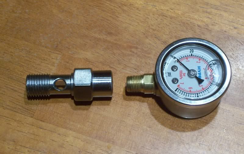

I ginned up this adapter last night for a oil pressure gauge to replace the right side banjo bolt that connects the oil cooler line to the head. I have not tried it out yet. (motor with BB is re-assembled but am waiting on new jets to finish up)

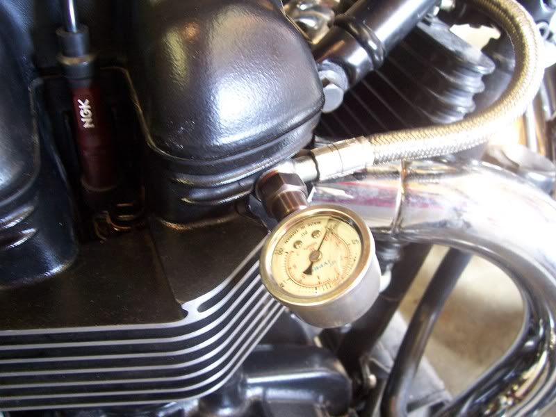

I had a problem with the sending unit on Wendys bike so her light came on and stayed on. The pressure was fine but I didn't know that for sure. If I had the mechanical gauge on there at the time it would have given me piece of mind. Also there is a better chance to catch a problem by seeing a drop in pressure before damage is done. With the idiot light , by the time they come on it's usually too late. You have to actually check the gauge as you ride to have a chance of catching a problem though.
These shots are my version I made a while back.

there is pressure there.

Micah,
Is that needle pegged?
Or am I just looking at it wrong?
Tony G '03 America
Re: Oil Pressure Gauge - Done!
TonyG #302604 02/09/2009 12:34 PM
Posts: 1,176
Posts: 1,176
Micah,
I suppose it is pegged, but at zero. the engine was not running when I took the picture.

When you say there is pressure there, what is it at when running down the road at highway speeds? at idle?
The_Dog33 #302606 02/09/2009 5:45 PM
Posts: 1,176
Posts: 1,176
I have not been able to take it out on the road (it is still winter here) the pressure I referred to is at idle and reving the motor where is sets. real proof will come with the warmer weather.
Sure looks like it's on the wrong side of the zero peg!
But surely it's not. (right?)
