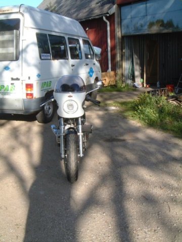

BTW, if there is no such thing as a stroker kit for the Triumph-Twin, - I wonder why Dinqua's friend Jojje changed out his stock connecting-rods for the aftermarket Carrillo connecting rods? The picture below (taken from Jojje website) shows the Carrillo connecting rods with the Weisco piston compared to the stock combination (Stock setup on the bottom).
Since I'm opening up the bottom end, I wonder if getting these would be worthwhile?
Input?
BTW, you can view the Turbo Swede's Bonnie here.
-BT

Those are the same length as the stock rods. IIRC, Jojje put those in because they're forged instead of cast and he needed them for his race bike.
edited to add: Check out this thread on Jojje's forum.
