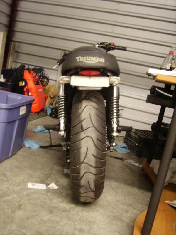

I got all the bits mounted. I still need to bleed the brakes and do some minor wiring, but it should be rideable in the next few days.
160mm rear tire:
Clean trees:
I can't wait to ride it!!!

Super Nice. Any idea how much lighter those rims are? =
saved about 7lbs up front and almost 10 in the back, even with the additional disc up front and the 160 vs 130 on back

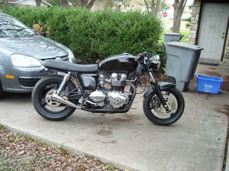

updated pics:
I've only ridden it about 5 miles to shake it down, I did a little tweaking and I'll ride it again this week. I hate that it gets dark before I get home though...

here's a new pic:
