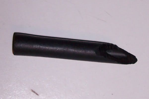

sounds like your gas vent tube is clogging up with water and causing a momentary "lock" in the fule delivery...check the vent line under the bike and then look into a vented gas cap.
YES YES YES.
Next time loosen the fuel cap when the bike stutters and this well tell you if it's your problem.
To fix it cut the fuel vent hose at an angle (facing the rear of the bike) Cut about 2 inches off.
Or visit Brent at Newspeedmaster.com and pick up the vented fuel cap. Then say goodbye to your problem.
Cheers!

Here's what I cut off. It fixed the prob.
06BA,-AI,NoBfls,K&NPods,TBS,155/45,2 3/4Out,SidGapPlgs,Wirsnbrs NawImPrityFknFarFrmOkMan

rwright #86148 11/19/2006 4:47 PM
Posts: 202
Posts: 202
what is that in the photo?
