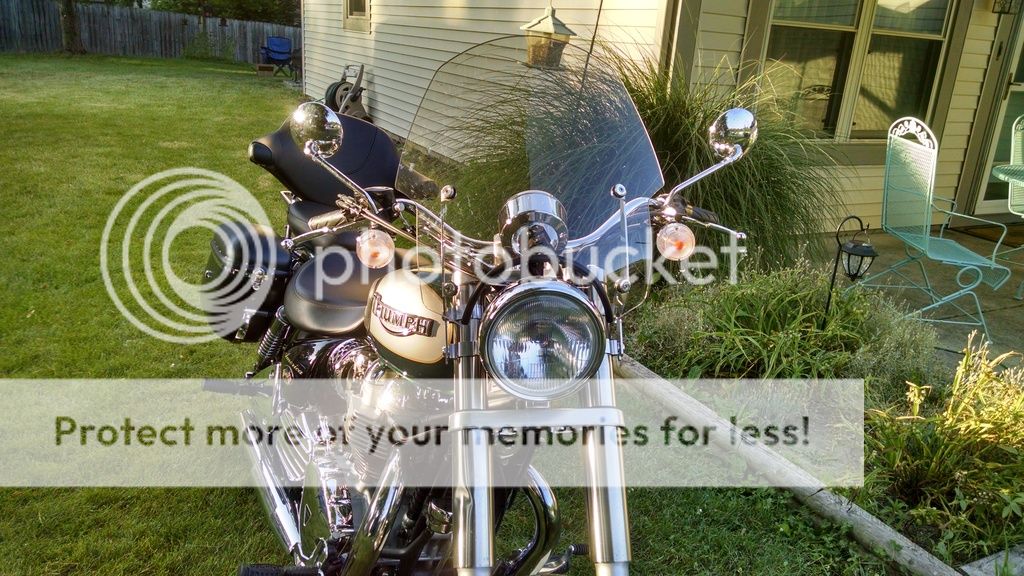

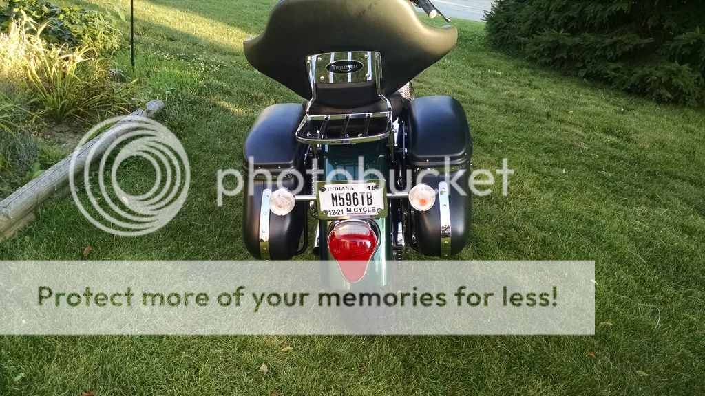

Re: Clear Turn Indicators
BillyIndiana #578859 06/14/2016 9:18 AM
Very cool ! 'speshly the "m cycle" sticker on the IN tag. Those LEO's must get confused about what kinda vehicle dat be.
Wade #578860 06/14/2016 11:21 AM
Joined: Feb 2013
Posts: 113
Joined: Feb 2013
Posts: 113
Looks so much better with the clear indicator lenses. Are those the Landrover Defender ones That you can get on ebay?
4x clear lenses & 4x amber bulbs for £10. You can't argue with that!
P19DJG #578861 06/14/2016 11:59 AM
Joined: Sep 2015
Posts: 797
Joined: Sep 2015
Posts: 797
Got these through fast eddy they fit right on. Hard to believe how much better they look.
