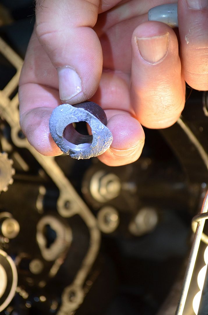

Reason I ask is, I'm attempting something similar to repair a broken Shift Shaft lever boss on a '85 Kawasaki GPZ that has left a hole in the crankcase. Proper repair (replace lower crankcase) becomes a BIG hassle, because, for the GPZ, according to Kawasaki, you MUST replace BOTH crankcase halves, as they're machine matched.
I've engineered (BWAAA...) a slip-over and clipped reinforcement piece, that I want to "reinforce" with epoxy. There is no measurable tension forces on this piece, only shear. (so I think)
I intend to epoxy the broken piece to the crankcase, epoxy the slip-over washer to the piece and the surrounding crankcase surface, and epoxy the bolted clip that holds the washer against the piece.

2) THE PIECE
http://i422.photobucket.com/albums/pp309/Opissant/DSC_0007_zpsozh8dze1.jpg

You couldn't ask for a much better break in terms of being repairable. I would get that case as clean as possible and have a good tig welder weld that back on. If you epoxy it that may be a problem if you wanted to weld it later.

I believe you want JB 8265S which is the commonly known two tube package that every automotive store has. I've used it many times, exposed to heat and oil and it just won't fail. I clean with Dawn dish detergent, followed by acetone and then rough up the mating surfaces with some 600 grit, clean with acetone again then mix and apply. The ambient temperature of the materials and workspace make a difference, I've had difficulty with curing below 40° and above 90°. I've built up engine block bosses for valve covers and drilled and tapped it. Built up case bosses in an old 64 Triumph and used it to hold a Helicoil. None have failed. Just my 2¢.
