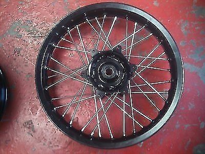

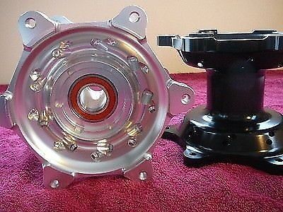

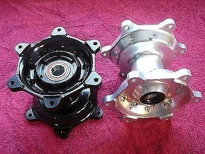

Oh, one other thing. I believe that our friend from Scandinavia got his TBS hub, complete rim actually, from one of the custom wheel building places in the UK and there in lies the confusion. Those places do not actually manufacture OEM Triumph hubs but custom copies. So, you may be able to get a "Tiger Style" hub from them that fits the Speedy but an actual Tiger hub will not. Here is a link to an example that I ran across.
http://www.ebay.com/itm/TRIUMPH-TWIN-DIS...362&vxp=mtr
And some pics from them of their "Tiger Style" hub that they claim fit the Speedy, again that is NOT an actual tiger hub.
