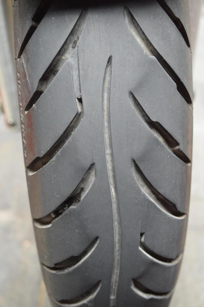

I put the Avon Roadrider on the front two years ago awesome grip but I am noticing that they are already scalloping just left of centre with maybe 12,000 km. That may be normal for the softer compound vs the Lazertecs which lasted 3 seasons or about 18,000 kms before that was noticed.
Maybe I have been making too many left hand turns and should find a different route.

Lots of rubber left on the tire but worn on left (right in photo) inflated to Triumphs recommended level for two up. I also over estimated kms I would say it is closer to 9500.

Funny thing about that is that it has more to do with the crown in the roads you ride on than turning.
I found this on the Triumph rat.net web site makes an for interesting read.
http://www.rattlebars.com/tirewear/index.html
After reading this perhaps we should set up a tire exchange with those that drive on the left side and perhaps can save all of us a good dollar/pound.

I was running low on pressure due to a bad gauge fortuneately it did not affect the rear very much. That and the effect of driving on the right and that Avon may have a shorter then normal life. Still like it just did 200km on back roads.
