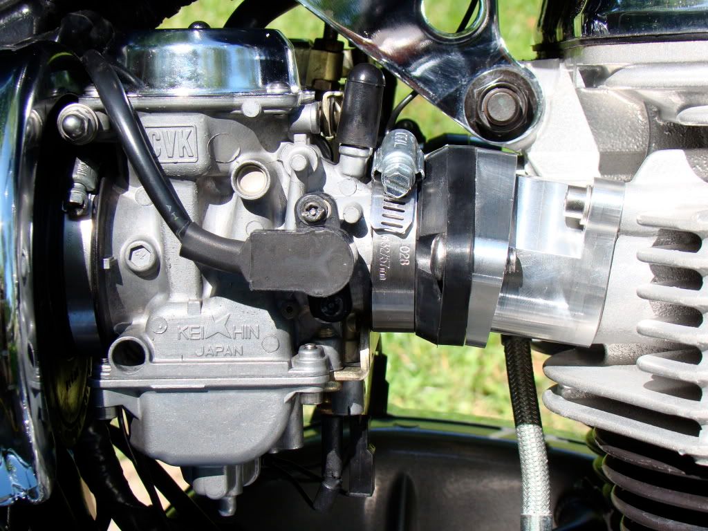

I'm thinking I want to go to the FCR's eventually too. I really like the power I got from my bored stock carbs, but you know, if there is more to be had, then I want it. Micah, you thinkn they would bolt up to those billet intake manifolds I have?

I don't know if they will fit as is. It seems to be the billet manifolds were all made to fit the Bonnie's. I am using stock manifolds with the rubbers flipped over.
If you want to take a close up picture of what you have now that would help. The other thing would be if the angle has to change, your billet manifolds could be machined to suit. I could probably find some milling machine time.

My manifolds are not like any others available. They have the angle for the carbs to sit level already

i beleive that if you bought the ones from British customs they allready have the angle built into them unlike the ones that come from Triumph performance, theirs i think were more for the 100's. I bought the manigolds from BC and the angle is good.
You have the original fast Fred manifolds right?
Do your manifolds run spacers between the head & manifold?
those are the ones
no. they bolt right to the head

then the FCR's should bolt up with no problems. 2 things come to mind; you will need to gin up a carb brace and you will have to tighten the bend radius on the carb end of the throttle cables. The layout of the linkage on the carbs sets higher and more offset than the CVKs so the throttle cable housings won't clear the frame. The engine not being centered in the frame does not help.

I have Barnett throttle cables and the bend is already pretty tight. The FCR's don't have a crossover linkage tube (whatever that thing is between them, you know what I'm talking about) like the stock ones do? What about the TPS? No more?

the FCRs are connected by a common fuel tube (ridged) fuel comes into the center, very similar to OEM. And by a hose between the accelerator pumps. Also a solid 'rack' bar holding them together.
the throttle linkage is similar to the OEM set up as far as how the cable ends go into a roler assembly with shafts going out to each carb. This is closest to the left side carb. Balancing is different, you set that at each carb because of the rocker type of slide lift.
very easy carbs to work on, so far as mains and needles.
TPS is still there and I am using mine. Did the little calibration procedure and it works pretty good.
Interesting idea on running the cables thru the frame. some electrical stuff would have to move and maybe work around the engine brace. I am sure it could be done.
