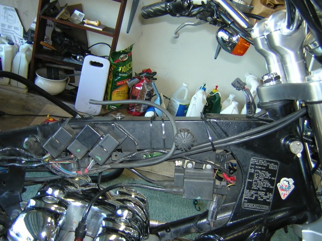

moe #525575 08/16/2013 1:01 PM
You can see the two coils and three relays.

Thanks for the picture Moe. That helps big time. As you can tell, I'm no mechanic. Switching the coil wires to test shouldn't be that big of a deal.
