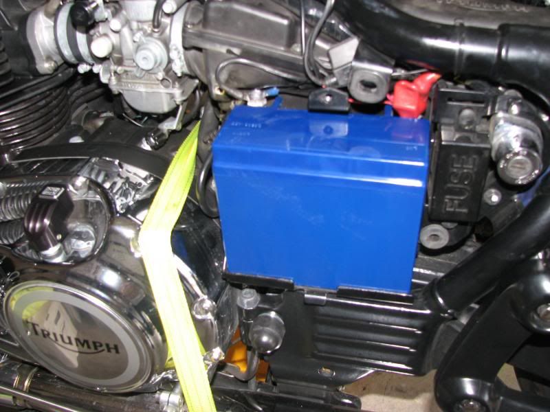

Well, I have to open mouth, insert foot. I just realized, it turns out the battery sits in place reversed. So the poles on that gel and the other options are correct. Which is good because I was considering having to cut the black electrical taped bundle that holds the positive lead (something I was really hesitant about having to do). So off to order my gel battery from a motorcycle dealer in the Vegas area (cheaper than Bikebandit). Hopefully it will be here by this weekend, the forecast is looking very good all weekend long. This gives me time to clean my beautiful brass battery cover. Since the seat is off, I'm going to clean out and re-oil my air filter. I might even finally install the Speed Bleeders I bought 5 years ago, I'm sure the brake fluid could use a change-out (I haven't touched it since I bought this bike used over 3 years ago). I'd do the oil & filter as well, but don't have the oil yet.

Just in case anyone is interested, I bought a BikeMaster TrueGel Battery MG12-BS which is a direct replacement for the original battery, YTX12-BS. You can buy it from Bike Bandit, but it's a little pricier and does not include shipping. I bought the battery on eBay on Monday and it arrived today. There are several places selling them for about $86-88 with free shipping. I found a place selling one for $78 plus $10.50 shipping. With the great forecast for this weekend, I didn't want to risk waiting even longer for a free shipped battery, so I bought the $78 one. Like I said, it arrived today. I measured 12.9 volts on the terminals out the box. It fit in the stock battery holder very nicely. After making all the connections, I smeared a little dielectric grease on the terminals. The only issue is the black plastic top cover piece. The dimensions of the battery are just a wee bit different, so the cover doesn't sit perfectly flush as on the stock. But it's minor and you really have to look to spot it. Here's a pic of the battery installed.  While things were apart, I decided to clean & re-oil my Unifilter and clean up the brass battery over. The brass battery cover still looks pretty good, although the darkened areas are lightening up. For example, what is supposed to be the blue field on old glory is no longer dark, so it's harder to make out the stars. Anyway, put things back together, and rolled her out to fire her up. She started with no problem, good and strong. Here's a shot of her, after I fired her up.  Afterwards, I installed the compass I got as a Christmas present. It's from Newbonneville.com. Easy installation on the right handlebar. It should complement the clock I have on the left handlebar.
