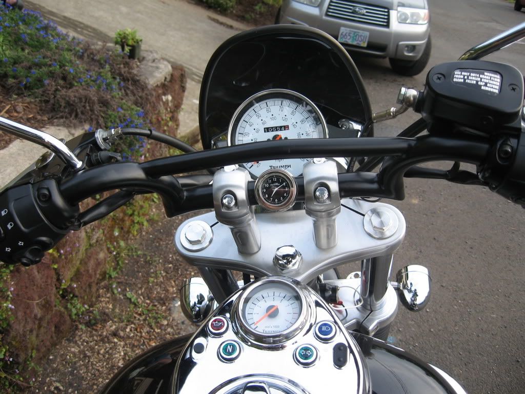

 Re: Cutting America Bars
Posts: 1,883 |
Or you could do like I did and buy some custom bars that are just slightly narrower. Of course this is an old picture but you get the point.  [image]  [/image]
