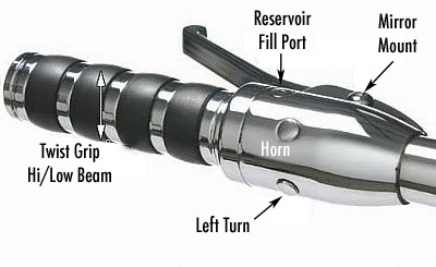

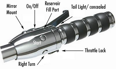

Re: Removing brake reservoir from handlebars
moe #507067 12/03/2012 9:01 PM
Just goes to prove that the only boundaries to "Bolt on Coolness" is only limited by how much can you or want to spend. Now that little slave cylinder they sell on their site, looks to be a mountable component for a juice clutch conversion on our bikes, that would be a great upgrade, IMO.
