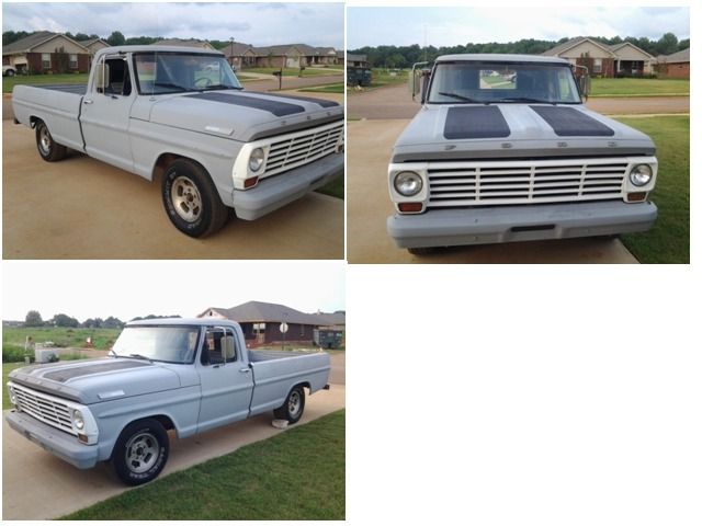

marty #498571 08/14/2012 9:52 AM
Posts: 1,669
Leithal Offline OP
Posts: 1,669
Thought y'all might wanna see what I'm working with here.
Re: OT Old F100
Leithal #498572 08/14/2012 11:37 AM
Posts: 5,272
Posts: 5,272
Nice!
