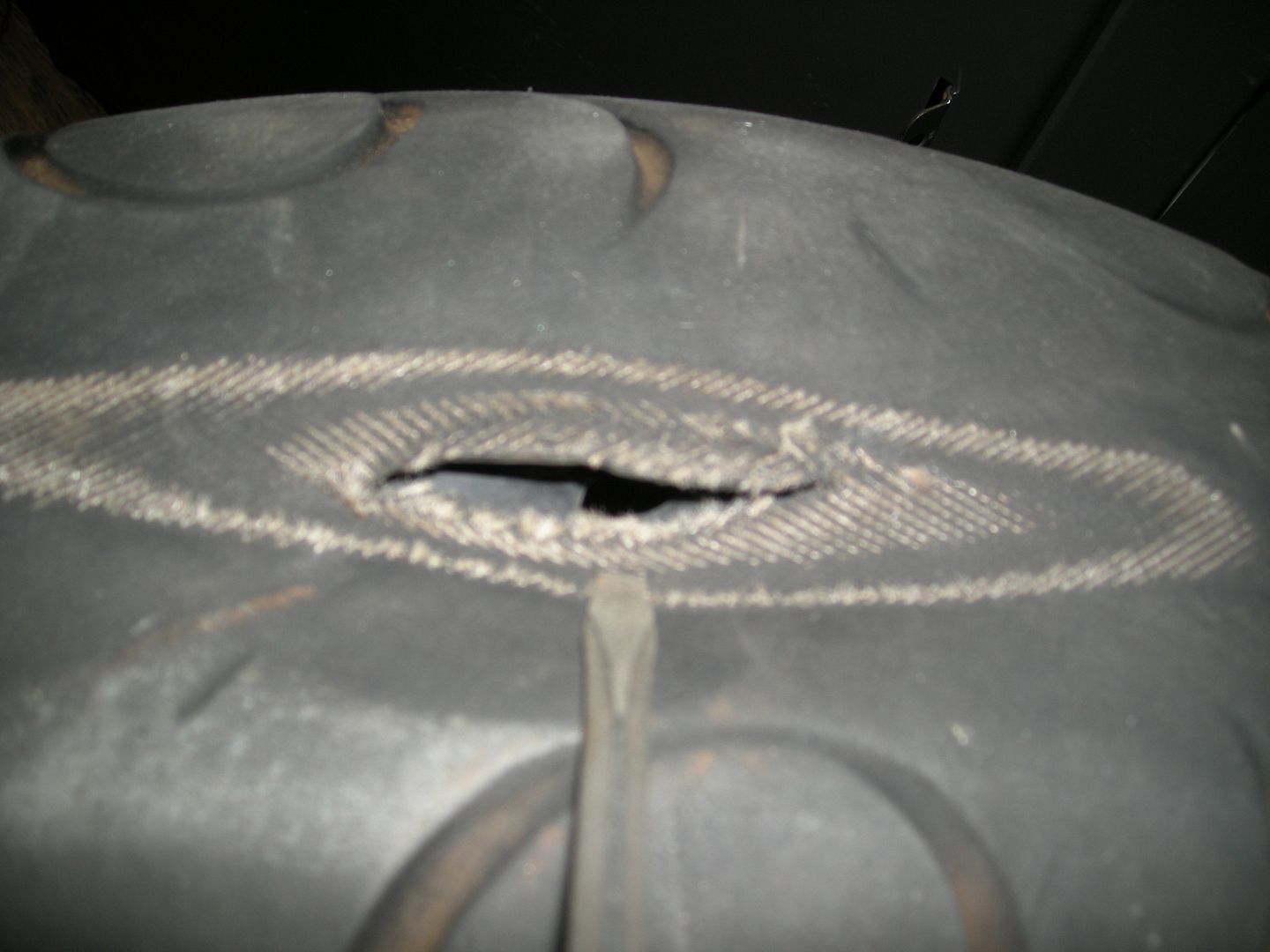

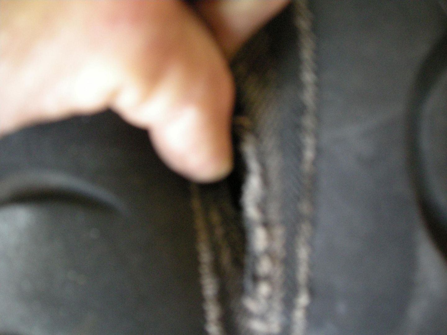

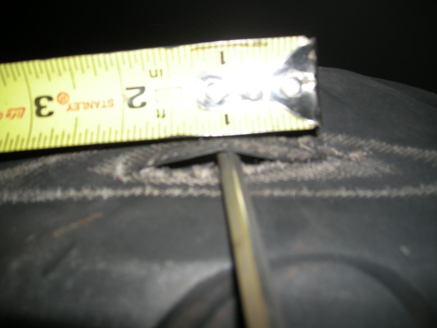

Yeah, the tire ripped open! I haven't dismounted the tire yet, but from looking past the rip, the inner tube has a hole the size of a nickel. It seems the tire blew because the tire case ripped allowing the inner tube to herniate through the tire casing and ride on the road. POW!

That is amazing,I'm on my 3rd Wild Flare and love them. Looks like it wore through in the center.

There you have it, I thought I remembered 7,000 so I guess it went a couple thousand more, I don't remember for sure. I ride pretty hard but I don't do burnouts and do a lot of twisty riding so I wear one the sides too. That tire looks like it has seen a lot of slab, might be the difference. Or looking back at the pic a nice skid in that spot.

The tire was thread bare 40% of the way round. I have never skidded it and I'm pretty sure John didn't either. I'll never buy another IRC Wild Flare Tire, but still will continue to buy IRC inner tubes. In the last two weeks I clocked 3700 miles on Prudence. A 6000 mile tire (actually a 4500 mile tire) is simple insufficient for my riding. Garbage. Total garbage the IRC wild Flare is. If this thread isn't an ample warning for those considering an IRC Wild Flare well then, never mind...
Of all the rear tires I've worn out, only two got less than 10,000 miles. One of which was an 880 and only then because I picked up a nail and given the tire was close to the end of it's life I opted for fresh rubber. The other is the subject of this thread.

I got like 9000 or 10000 out of the last one according to my post, held the road great and love the tire. I disagree about the garbage assessment but your opinion is your opinion and I don't want to argue the point just as my opinion is mine. I do have a question though, did you have any vibration? I am in the tire business and worn out 40% of the way around is usually a balance issue, worst wear being to one side of that 40%. Could have been a defective tire too, I see those from all manufacturers and out of round would cause that sort of wear too but again you should have had a vibration.Just trying to wrap my head around the failure since I have had such good luck with them, 3 now.But I also got 23,000 out of my OEM Lazertech front and it wasn't totally bald yet but was below 1/32.
