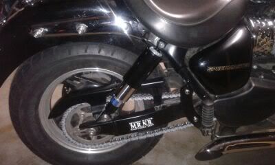

I just bought these Hagon's. They have truly improved the ride, and I like the way they look.
[image][/image]

I like the way they look too, Brent!
They definitely have a similar look as those retro-style Girlings that Michael was asking about here.
Now, my biggest concern about shocks has always been their rebound damping properties. If there is little to none of that, such as on the stock shocks, then the rear end just bounces up and down after compression and leads to rear end wallowing.
So, you're sayin' that with these Hagons here, you haven't experienced any of that since mounting those, right?!
(...btw, if ya don't mind me askin', how much were those babies?)

Hey Dwight,
They are the Hagon Classic III's.
What I have noticed, and I've only done one longish ride (about 500 miles) and a few day rides. The back end feels less squirrely. It seems to stay more planted, definitely stiffer, yet over bumps/potholes it does seem to be less jarring. I only have the stock shocks to compare too, I was looking at the progressives, but I, like Michael here, was interested in the aesthetics too. Yes, I like them, but I didn't know what I was missing until I had something (anything) better. I paid just under $300.00.
When I ordered them (though Cascade Moto-Classics) they took my weight and riding style, and they are adjustable. I do wish there was some information on which way to adjust them for heavier loads, or different kinds of riding. I'm afraid to screw them up.
They will get the real test when I head up to Nelson. Nothing but twisties up there.
