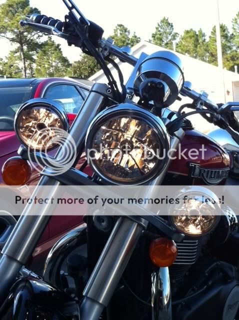

Here is how they look. The light bar is a rivco.
