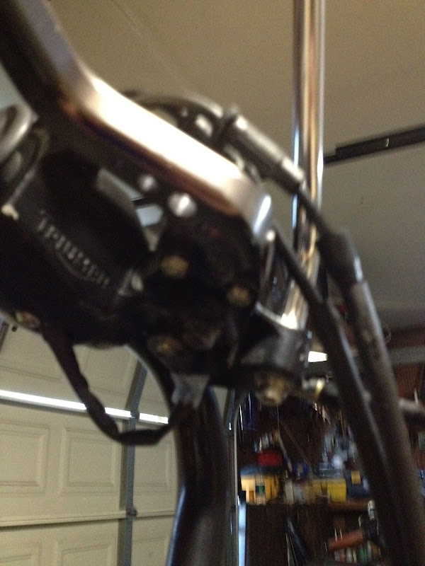

getting ready to do this finally. does anyone know what the colors are that i need? and yes i am that anal.

Joined: Jan 2011
Posts: 379
thanks to the skill of SSjones, my stealth wiring is almost done

curious if you guys know how much taller of a bar you could put on before needing to get longer cables and or electrical extensions for a 12 speedmaster. I scored some 14in. nos apes 36in wide curious how they would fit. Eyeballing looks close.
i like my motorcycles like my women, fast, dirty and cheap 12 Speedmaster/67 Tiger 650/78 xs650
Re: running electrical inside handlebars?
taggat #471616 04/02/2013 10:34 PM
You are going to need to buy longer control cables and splice in the wiring. 14" Apes will definitely require it.
