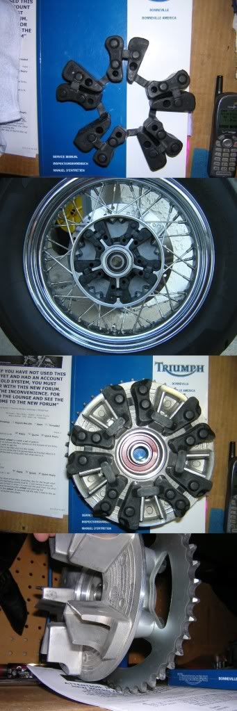

As pointed out to me by a poster on my original thread, so of the "jerkiness" (besides a reallllllllly worn out chain!) could be the cush-drive. Thanks to FeHorse for telling me what the heck it is!
So my question is: how often have any of you ever replaced this part? and at what milage?
My bike's got 27k on it.

only the once Buddy @ about 5000k (some folks have had to replace @ 1000k even)
replaced it with a cush drive from a mid 90's ThunderBird Sport 50,000k's later still all good

Replaced the original with a T-bird one at 18000. Much better fit.

I did mine when I did chain and sprockets. It wasn't shot, but did show wear. I figured I might as well get all the slop out of the drive-line. I have no way of knowing how big an impact that made, but, I was pleased with the result. Oh, and my mileage was at about the same as yours - 27ish.

I would check with Fast Eddy for chain needs if you have not replaced it yet. I would also check Bike Bandit for the cush drive. #7 is the drive for the Thunderbird sport. Many say that is the one to get.

Like it's been said, no set interval. Mine lasted until about 30.000 miles. I replaced it with a Thunderbird rubber, and got a bit tighter fit than stock. There should be no play with the cush drive rubber. If there is, it could cause the chain to stretch. The Tbird part # is T2012211.
Replaced both mine with the Tbird ones and have not had anymore concerns with them. They last that long.
I replaced Cinnamon Girl's with a Tbird Cush rubber on December 6, 2007 with 22,785 on the odometer. She now has 77,218.
I replaced Vera Lynn's with a Tbird Cush rubber April 11, 2007 56,900 on the odometer. She now has 90,400.
I had replaced Vera's oem cush drive with another worthless oem cush drive March 2nd, 2005. Mileage record for that is at home.

Will I need a special tool to install/dismatle the axle so's to replace the cush drive?
And where (mail order) should I go to get part #T2012211?
edit: sorry saxtron, I just saw your post about bikebandit... I just ordered it!

No special tools required. Just the normal stuff in the tool box.

I replaced mine with the T-Bird part # as stated above - my original still looked fine after 30+k miles...changed it with rear tire change.
I honestly can't say I could tell any difference...40k+ later now, still can't. I wouldn't even know what a worn one might do....

My cush drive was replaced on warranty by my dealer (with T-Bird version). 20K later it is still tight. The change was recommended by Triumph and I think they changed production to that later - or least my dealer thought so. My original was loose after 2k miles (2005 America).

The most difficult part is getting the wheel off and the original chain. My friend Donny had to use a dremell on one of the links since it doesn't have a master. The cush drive is easy to put in. I had close to 25k when we replaced the chain and cush drive and also a rear brake rotor. I think you were asking about the different size sprocket in a different thread. I believe we went with a 19 tooth because it was kind of like having an overdrive since I do a lot of highway miles. If you want to be quicker off the line, then the 17 tooth is the way to go. I think that is what is standard on the SM. Have fun.

I personally would not use a used cush drive as you really don't know what kind of mileage it has on it or how long it has sat (i.e. rotting rubber or cracked). Play it safe and buy a new one.

To check the cush drive, simple grasp the rear chain ring and try to rotate it clockwise then counterclock wise. You should observe very little rotation.
