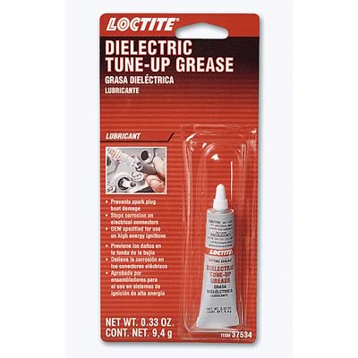

Sometimes dielectric grease is referred to as 'tune-up grease'. Permatex makes it.

You can find this at any of our local auto parts stores but if you ask for dielectric grease you'll get a blank look, they all only know it as 'tune-up grease'
Re: Weather-proofing our Triumphs?
oldroadie #447701 07/12/2011 4:09 AM
[image]
Thanks for the info and the picture. I'm gonna look this up tommorrow, as it seems like a good idea to use.
