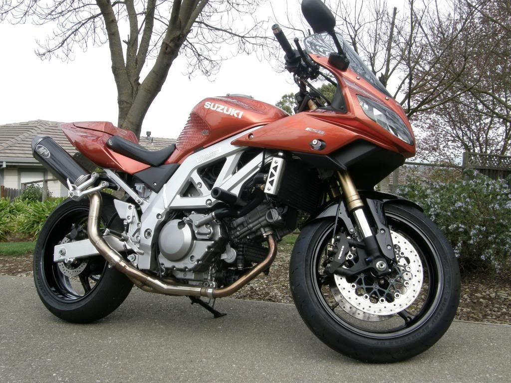

Michelle's 2003 SV650S
Body, Plastics
Laminar Screen
OEM Rear Cowl
Hot Bodies Undertail FE
Engine, Performance
M4 Carbon Exhaust
46T Renthal Rear Sprocket
Suspension
2007 GSXR 600 Forks
Elka Triple Clicker Rear Shock
GSXR Tokico Radial Calipers
GSXR Nissin Radial Master (Front)
Galfer Brake Lines
Wheels/Tires/Brakes
2009 GSXR 600 Wheels
310mm GSXR Front Rotors
GSXR 5.5" Rear Wheel conversion
- Twin Works Factory Kit
Dunlop Sportmax 120/70/17; 180/55/17
Ergonomics
Rizoma Conical Bar Conversion
Rizoma Sportline Grips/Bar End Sliders
Pazzo Levers
SW Motech Bags Connection Tank Bag system
Corbin Seat
Electrical/Electronic
Healtech GPI/TRE
DEcosse FH008 R/R conversion.
DEcosse Headlight Relay/Starter Cut modifcation
DEcosse LED Rear Turn Signal Modification
Rizoma Avio LED Front Turn Signals
Flash2Pass Garage Door Opener
DEcosse GSXR Speed Sender Integration

Here are pics of the SV and TL as purchased
The SV was clean but bone stock; the TL was a beater!
and after
