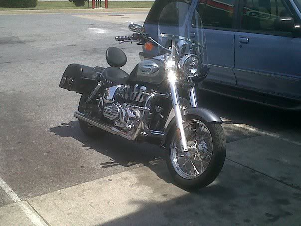

took me forever, and it a crappy photo; but here is a shot on my TBA with the new chrome side cover.

a little better shot, i think it really give my bonnie bonnie that pop it needed.

I like it. Then again I say there is no such thing as enough chrome.
Have you ever tried the Garden Gate/Harmonic Triumph badge? That theme would look fabulous with them.

I added a sample in my above post on one of my bikes.

AH! i thought you meant the old triangle affixed the the side panel. i went with the eyebrows for nostalgia, my old 65 had the eyebrow.

Thanks for the pics Bill. Cover looks good.
I noticed the quick attach on your shield. What type of mount and shield do you have?

Beautiful
I'd do something about the reflectors on the forks though
I'm rather curious about that too.

That looks like a Victory shield. Probably a Memphis application.

Gregger et al,
ok here is the skinny on the windshield...mind you i had to learn some of this the hard way...
the shield you see on my bike is a Memphis Fats, the mount is for a Suzuki Marauder. i got mine from fasteddy (best price, best deal, best service) http://www.fasteddysports.com/ if you are looking to get one i would strongly suggest calling eddy and talking to him, he can advise you on the height etc...trust me, take his advice he knows of what he speaks. i thought i needed a 17 inch so i could look over top it; but eddy told me i would be better with a 19 and look through it...i have the 19, no buffeting no rain in my face... if you find someone who polishes metal the aluminum mounts polish up really nice. now (and here is where i had to learn things the hard way) what kit you get, depends on your year. if you have an 06 or older, you get the Memphis Fats from eddy, BUT if it is 07 to 10 you can get a switchblade from National cycle (you want what is called the chip special)
any of their shields with:
Mounting Kit - Q102
Tapered Top Strap (x2) - 73 37-370173-000
Tapered Bottom Strap (x2) - 73 37-371174-000
i have the directions on how to apply somewhere MIND YOU THIS WILL NOT WORK ON 06 OR OLDER (do you get the idea i bought one and couldn't get the d@mn thing on?)
hope this helps!
