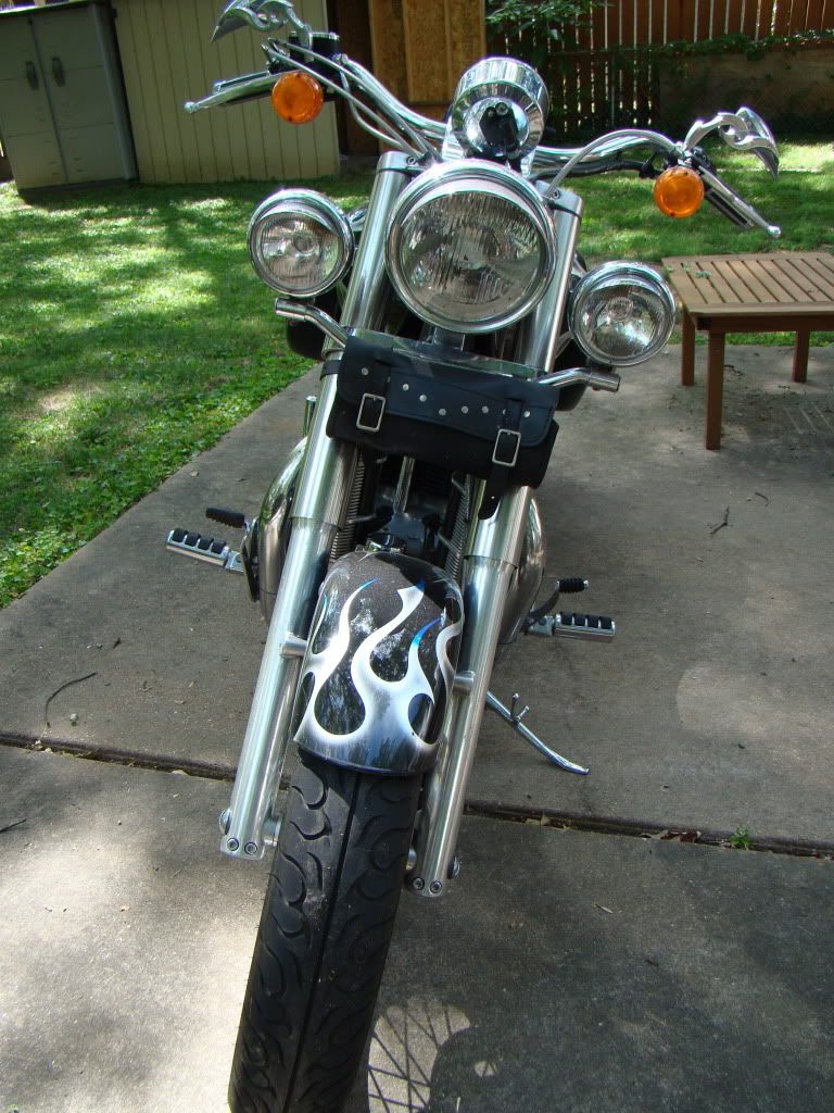

Keith #437817 04/06/2011 3:07 PM
or like this....
Its a Triumph light bar that been modified. Triumph bar with the ends cut off and P clamps to mount the lights buckets and SS plugs on the ends.

Hey Keith, that looks great! What type of headlight is that?

or like this....
whats the width measurement of the bar!

Dave, I've been thinking of sectioning & rechroming the "bug bar" to retain the OEM mounts, however the more I think this through it's gonna be more than I want to spend. P mounts are looking better to me.
When you cut the OEM mounts off of the ends of the bar, & then capped the ends, how are the wires routed to the lights? Is there a photo available of that detail?
Re: high and tight lightbar
B02S4 #437830 04/09/2011 9:53 PM
I can take a pic tomorrow, I just drilled new holes next to the P-clamps

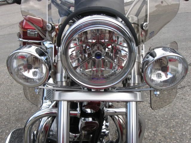

Or cut your own out of flat stock...
FJ, what brand buckets are your spotlights? are they 4.5 inch?
ce7871 #437832 01/04/2012 2:23 PM
They are the lights from the Triumph lightbar kit. I believe they are 4.5".

Is this what you're asking about, Bill? Maybe not, 'cause I didn't set them up with a quick connector but they are close to the headlight.
Keith, which main light deflector are you using?

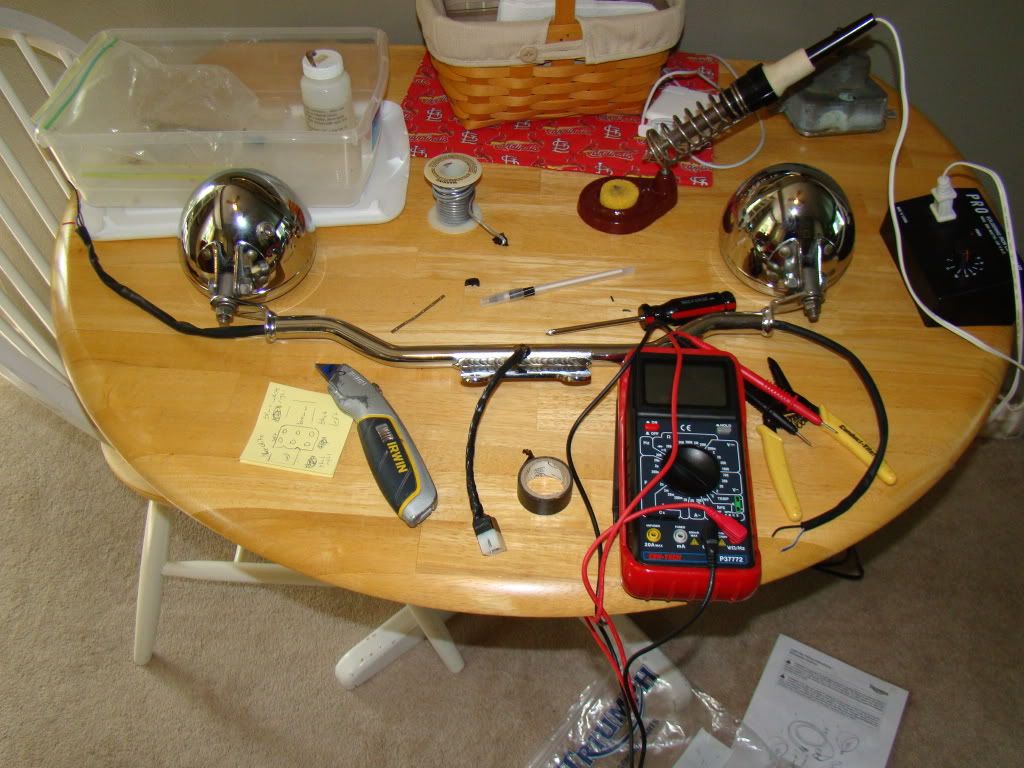

For anyone who has installed a standard OEM Triumph light bar setup, I have a trouble shooting type question:
I removed the seat and gas tank, found the correct connector, plugged everything in and tested the lights.... both lite up, toggle switch worked, so I'm thinking great! I go ahead and run the wires through the bar and headlights, mount the bar under the fork, bolt the lights on and test again... this time nothing.
What could have happened between the first test and the second? All I did was run the wires through the bar.... could I have pinched or broke one? Did something blow?
I'm not joe-mechanic so even the littlest of details will help me...

Check your fuse first. If its blown then you shorted it. If not then...
Check both lights? Theres a wire that holds the lights in place that for some reason doesn't make a good contact till theres some vibration.
Also.... check your ground wire.

I haven't checked the fuse yet and need to look at all the wiring inside the lights again.....what wire are you talking about that holds the lights in place?
I had a hell of a time running the wire through the bar, really pulling on them to get through, I hope I didn't break one there...

Left bucket, the one with the switch...anyways inside that look for a wire that is chafing er grounding out intermittently. Seems like corporate got cheap on the insulation. or at least it appeared that way 8 or 9 years ago.

OK, regarding the above trouble shooting question here's what's happening and what I've done to this point:
I have no illumination to the light bar and the driving light is also out. Main headlight is fine.
I checked all the wire connections inside the lights, they all seem fine.
I have checked the accessory light fuse (and all the other fuses for that matter)All still solid. I even switched out the accessory light fuse to the headlight fuse and it lite the lamp so I'm fairly certain the fuses are not the issue.
I pulled everything back apart and noticed that I flatten out a few inched of the wires running under the support bar when I attempted to install it. I sliced the black wire jacket off carefully to reveal some pretty flat wires. Not sure if that is the issue.
If the wires where compromised during my install and indeed shorted out, would that blow the driving lamp?
I THINK I may need to replace the wires from the split (where they go to both lamps) I really don't know what else to do.
Any more help.....

...some pretty flat wires. Not sure if that is the issue...
It is possible that one or more of those wires are broken internally.
I may have a spare lightbar wiring harness left over from a project; replacing the wiring harness will be your last resort. OK to PM me if you need to go that route.

Would a broken wire blow the drive lamp out? ...I'll keep working on this for the next couple days but it looks like, right now anyway, I might need a new harness... Thank you for the offer,I really appreciate the jester...

Regarding the trouble shooting question above:
I'm replacing the low beam lamp that I believe I shorted out will attempting to install the bar, is the cause of the light bar failure.
I'm having a hard time finding a the exact 12v/14w bulb that came out of the headlight at any of my local (NAPA, Advanced Auto, etc, etc)car parts stores. Will any 12V bulb work?

No.
The OEM headlight is H4 bulb
The OEM passing lamps are H3 bulbs

Having no low beam will in no way effect the light bar. For years I ran with no low beam and simple flipped on the light bar. Then one afternoon in New Hampshire when my friends told me my tail light was out, they also fixed my lowbeam! Newt knows about out of town repairs too!

Ha! Awesome! This is exactly what I have discovered. I eventually found a blown fuse for the side lights which happened when I was installing the harness... I guess I should have disconnected both battery cables, not just the negative.
Anyway, I now have a newly installed lightbar , but still no low beam, but like you said, no need for the low beam,just leave the light bar on.
I still have no idea what happen with the low beam (I tested it and it still lights so a wire issue maybe??)
Right now it doesn't matter, I'm all set with this bar... love it!
thanks for the replies, they were helpful...

The plug for the headlights located in the headlight bucket had one connection arch out and vaporize away: yes, the connection for the low beam. Rob bypassed that oem plug for me a couple of years back. So now there are two plugs where one once was. Heck just the other day I did a walk around (actually every morning) and noticed I had NO headlight. low or high. grrr. Fixed it as it might have been a fuse connection. not quite sure. Took the headlight ring off and checked those connections, but did not unplug replug them either. Kinda why the fuse is yelling at me.
..vaporized, wut? hahaha... this is getting interesting now...blown fuses, they're for pussies, we're talking about VAPORIZING stuff!
So, do you happen to remember how your man bypassed the OEM plug to fix this silly little lamp?

edit: I should add the fuses are just breaking in the middle, they don't appear to be melting, so grounding?
repoman #437851 06/13/2012 11:03 PM
Joined: Apr 2012
Posts: 30
Joined: Apr 2012
Posts: 30
Although the tail light and Aux lights are on the same fuse they are not in series so the wiring is likely fine in the tail light circuit. I would also say the wiring is fine from the fuse to the hot side of the light bar switch. Start tracing wires from the switch terminal to the bulbs. That to me seems the most likely point to start. Hopefully you will find that a connector just pulled out in the light bucket and is touching a metal part of the frame and you can just plug it together.
I am not sure what you mean by fuse melting vs breaking. teh plastic part of the fuse should never melt, and internal metal part should melt to open the circuit and stop the overload
robj #437852 06/14/2012 4:49 PM
Joined: Mar 2012
Posts: 80
Joined: Mar 2012
Posts: 80
I've had both light buckets apart to check for any obvious problem, I do not see any breaks, rubs, loose connectors, etc. This is why I'm thinking maybe the switch is bad, but again, I don't SEE anything that could be construed as a problem. I'm heading down there again to take another inspection.... don't know what else to do.
