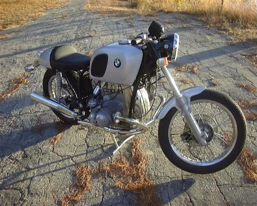

I did this '75 R-75/6 a few years ago. I bought a basket case with a clean title and got the cafe seat pan and cover on Ebay,as well as the MAC exhaust and some other bits. This was a great bike.
Strangler
Re: BMW anyone?
chopperpaul #435550 03/28/2011 7:40 AM
Nice! Cafe seat and cowl and Reynolds ride-off center stand, too.
Almost got mine ifired up yesterday, one of the POs had really bent the tabs on the floats and one bowl was bone dry. Then there's the issue of mismatched float valves, although I did manage to tweak them enough to keep from peeing gas all over the shop. I won't even go into how badly the throttle was set up...
