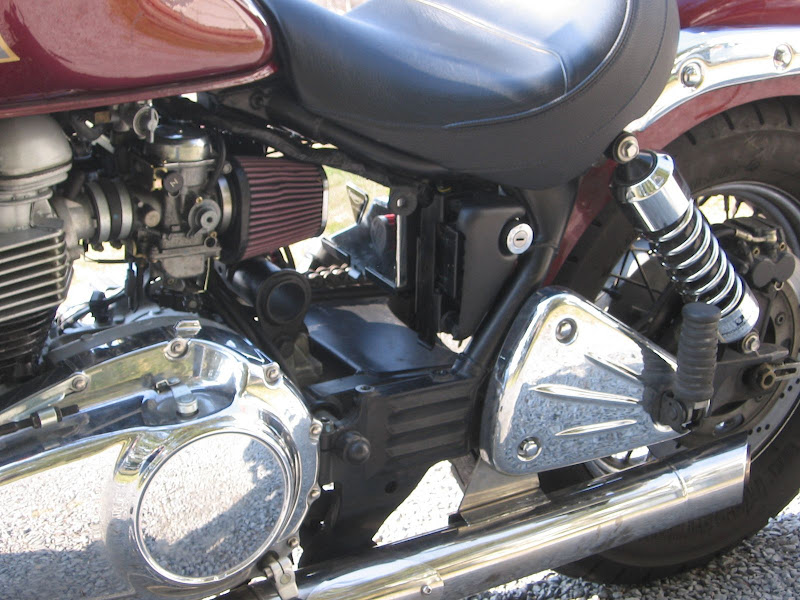

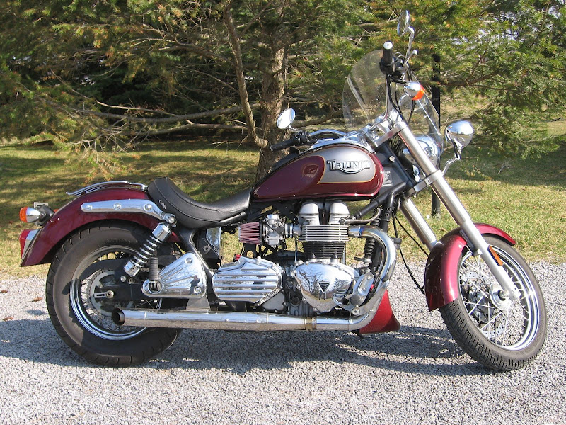

+2. I think the relocated battery box that Tom is supplying looks better than the freak. Here's a couple of pics of mine after I installed Tom's kit last winter. The only change I would consider at this point would be going to the flat filters that Erle is sporting on his bike.

I don't recall seeing the fuse block and ignition switch mounted that cleanly with Tom's setup. Did you do that or has he modified his bracket? Or am I smoking crack?
Re: no freak
FriarJohn #426202 02/18/2011 12:34 AM
Posts: 525
Posts: 525
I wanted to keep the fuse box & ignition switch in the stock position. I pulled the whole battery tray assembly off, cut off the tray but left the rest of the mount that supports the fuse box and ignition switch enclosure intact and then remounted it all.
Re: no freak
The_Insane_Viking #426203 02/18/2011 1:59 AM
I like it I was just wondering what all was involved. Tom's bike doesn't look bad or anything but yours looks almost factory.
Re: no freak
FriarJohn #426204 02/22/2011 5:07 PM
Yeah Carl you laid that out really nice. Ive seen another variation where the fusebox faced forward, I didnt like that one as much.

Very nice! I love the clean look of that and love even more the idea of doing it myself.
Who is the "Tom" to which you are referring, and how do I go about getting one of his kits? (I'm still new to the forum and trying to associate everyone/everythng).
Any issues with the air filters shaking loose, or is there something other than the "hose clamp" keeping them on the carbs?

Some have had an issue with the pods staying on but in most cases it is from over tightening. I have never lost one off of either of our bikes.
Re: no freak
The_Dog33 #426210 03/10/2011 12:33 AM
I did, early on. Then I safety wired them. Then they almost never came off (I think just once after that).
I found the first one I lost on the highway. It was crushed bad. One I never found.

I want one of those custom brass battery covers with my bulldog on it so I'm going to have to do something like this to replace my battery box or just buckle down and buy a bracket from Tom. I totally dig Carl's solution for the fuse box and ignition, with the stock cover.
Re: no freak
FriarJohn #426214 03/10/2011 6:32 PM
JUST CONFIRMED!
I talked to Carl (insane viking) and he confirmed that my design will accomodate this fuseblock/ignition setup.
So all those interested....YES you can have it like Carl!
