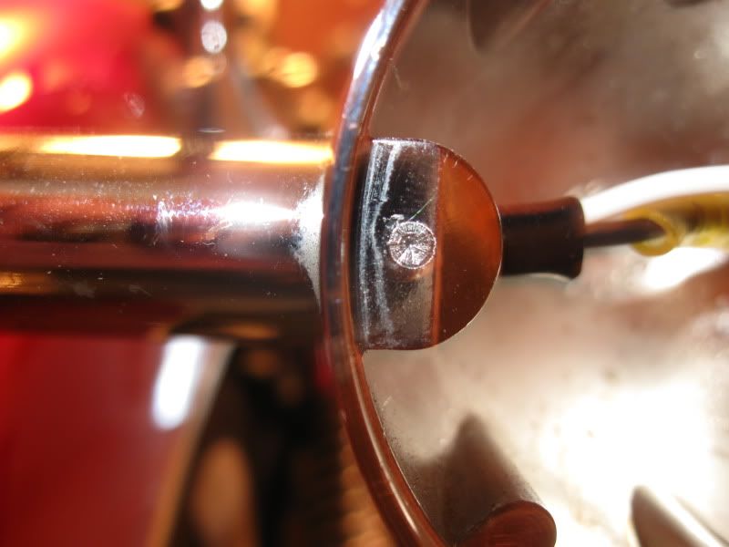

Now, this sound like a REAL dumb problem, but I need help with removing the rear turn signal light housings. With lens off, it appears as though they screw into the stems. But I can't get them to budge... is there a little tiny friggin' set screw in there? Or maybe the stem and housing are not supposed to come apart?

They do unscrew but i think they use some sort of lock tight Mine were very tight but they do come off
A bit of heat might help , put them out in the sun Opps you dont have sun do ya

Yup, you guys were right... just work at it and it comes off.
