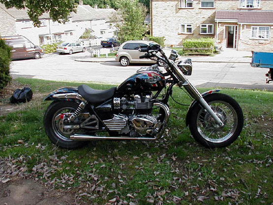

Haven't ever heard of rake cups being used on hour bikes. I've seen people who've machined new triple trees for the bike to increase the rake. And I've seen at least one bike where they actually chopped it to extend the neck 5 degrees. Got a picture of that one...
Note the gap behind the neck--they didn't replace the stock gussets.
