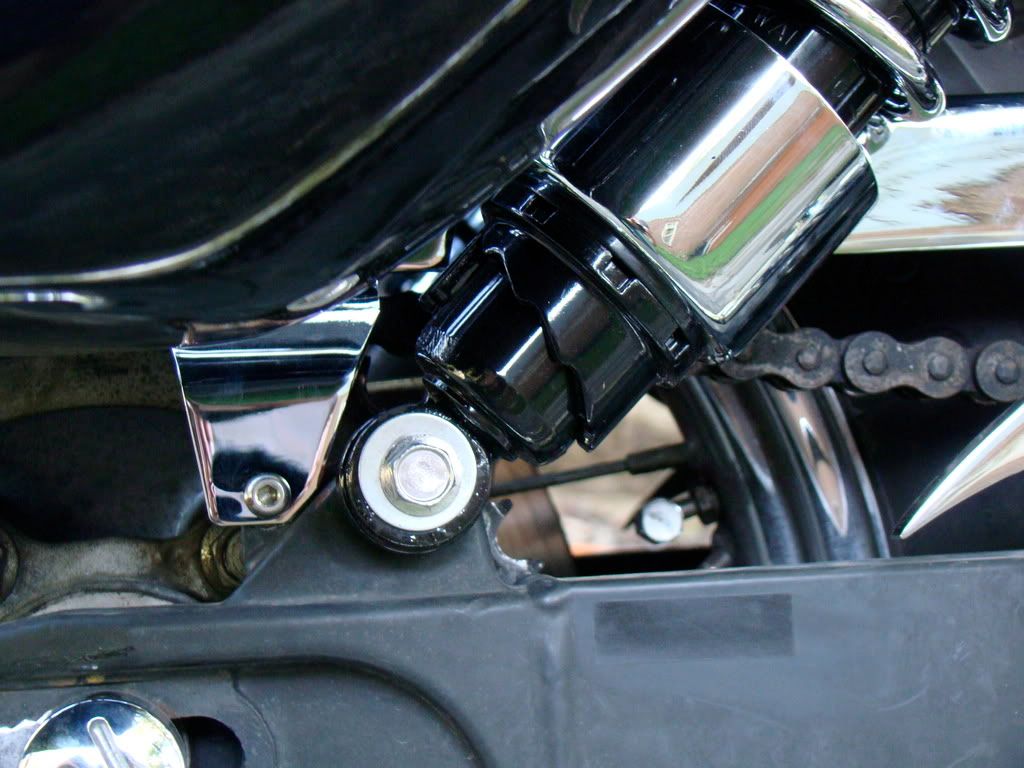

there are plenty of pics of the broken ones in the thread "Broken chain guards, how many?", but here are the pics I took of the new redesigned one. You can see how it's no longer one solid pressed piece, and the tabs are way thicker than before.

That new one looks stronger.

It's been a while since a break has been reported, so the new design must be an improvement. Mine broke no where near the new gusseted section, but rather on that small tab mount hole.
When mounting my replacement, I bought a small chrome washer, and cut it down to fit that slanted angle. So far, no problems or evidence of fatigue.

Mine broke at the hole too. You can see the new design has more steel there at the mounting hole, and the steel is a larger gauge than before. Very stiff.

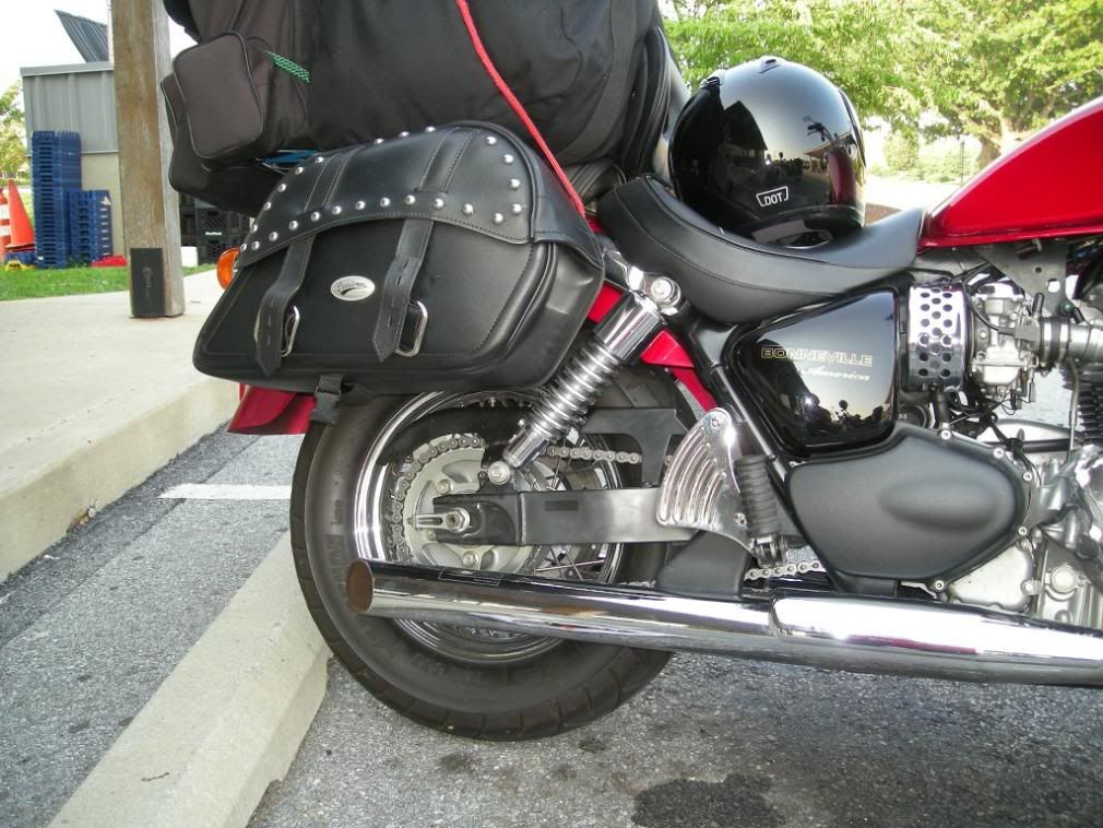

Chain guard #2. Photographed at a gas Station in Pennsylvania with the English Yankee while we were en route to the New Hampshire Rally 2008.
