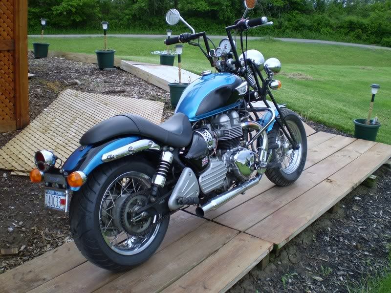

yes they have Grzegorz has put a 17"rim and I belive its 5.5 or 6.0 wide on the back of his bike and is running a 200 wide avon on it.. I am runnig a 16" 5.5 wide on the back of running a 180...

no I got my rim off ebay..16" 5.5 wide 40 hole "Excel rim" and order my ss spokes Buchanans and my friend laced it up for me..
