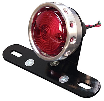

I found this tail light on ebay the other day that I thought was pretty awesome
http://cgi.ebay.com/ebaymotors/ws/eBayIS...RK%3AMEWAX%3AIT
Looks like the (far more expensive) Rapide line from crime scene choppers......

I guess you cant patent "cool"...haha That one on ebay ist like $85 is the crime scene one more than that? I thought $85 was outrageous..haha I kinda like more slats going across
Re: Cut rear fender BETWEEN tail light & license plate
brokenfixed #395822 07/22/2010 9:33 AM
The Rapide stuff (taillight, headlight, signals) tend to be around $3-400 each.
