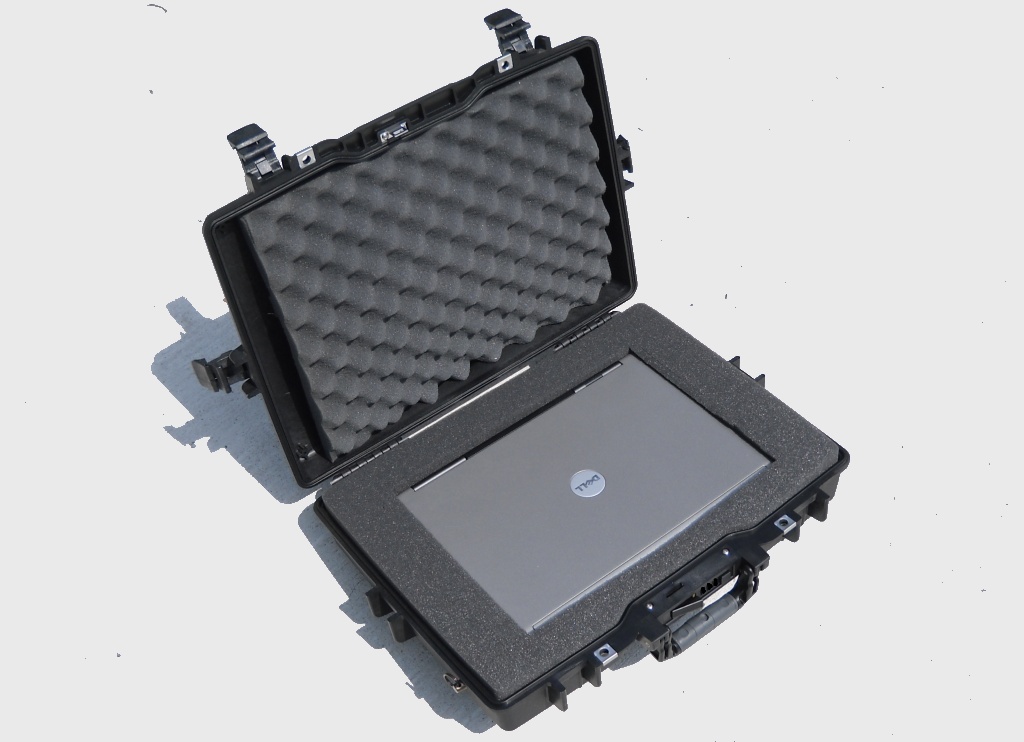

OK, I know this isn't for everyone, but a few months ago I set up two Pelican cases as hard bags on my Speedmaster. Occasionally I need to carry a notebook computer and accessories with me, which is what prompted me to do this.

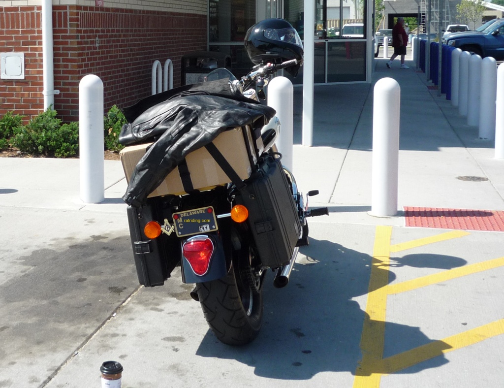

The above photo shows a full-sized desktop computer securely mounted to the rack and the Pelican cases. I transported it nearly 200 miles exactly as you see it.

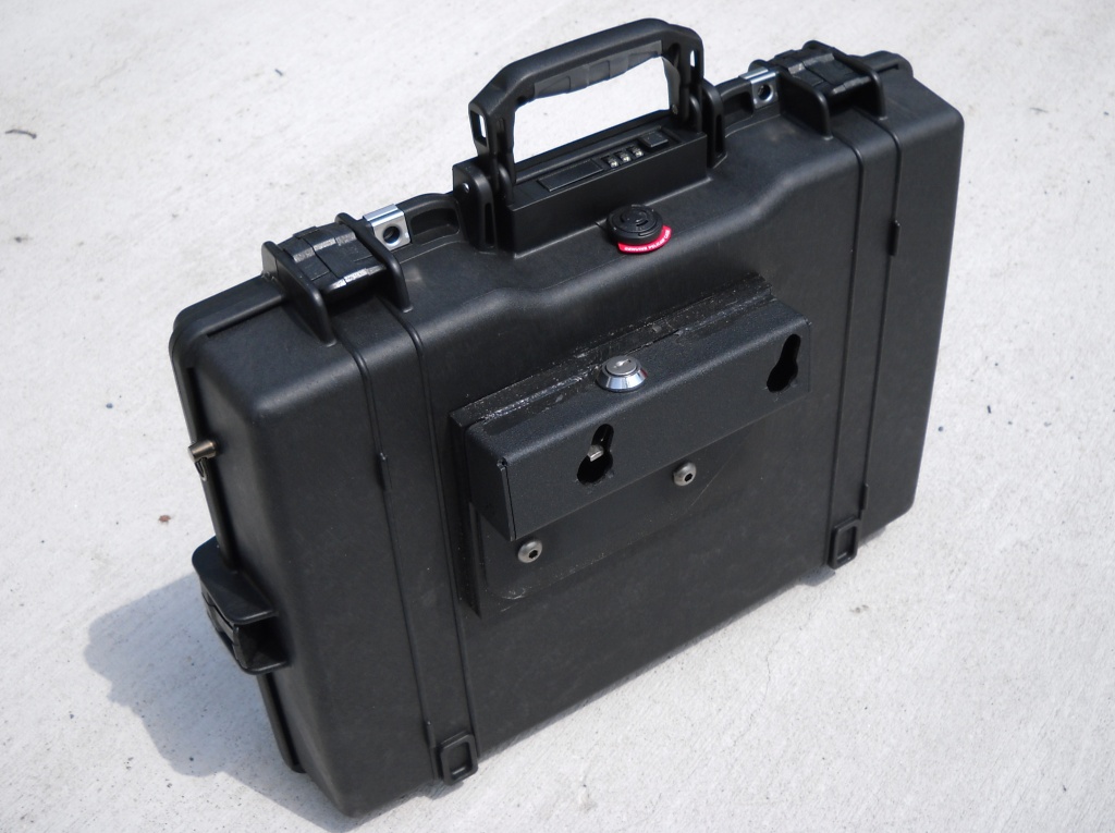

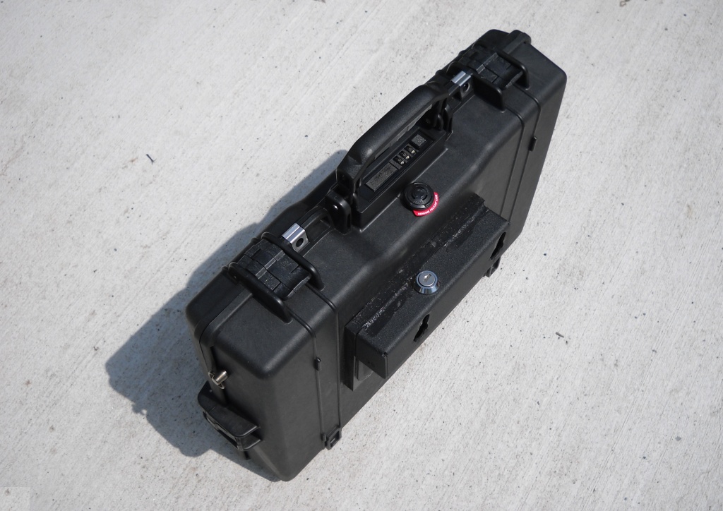

I used Easy Brackets to mount the cases, and made sure they were keyed the same as the Easy Brackets I use on my leather saddlebags. The Pelican case, with a 15" notebook computer and padding inside is just under the 15 pound load limit of the Easy Brackets.
I know they don't look that great, but they are very functional on the rare occasion that I need them. I positioned the Pelican cases so their tops would be even with the top of my solo luggage rack, which gives a nice wide area for securing larger cargo.
If anyone wants more details, let me know.

Since there's a little bit of interest, I'll give you a few more details.
In order to clear the shocks, I had to put a spacer between each Easy Bracket and case.
I ordered a 12" square sheet of 1/2" black Polyethylene from Mc-Master-Carr. I then cut a piece for each case, and fastened it using stainless button-head bolts, stainless fender washers, and thin stainless Nylok nuts. All of this was sealed using black silicone. I could have replaced the nuts and washers by cutting, drilling, and tapping a small metal plate to place inside each case - but I decided to try the easy way first. This method has worked just fine.
The computer fits nice and snug, and the cases have not leaked in the rain. Just to be safe, I usually place the computer in a plastic trash bag before locking it inside the case.

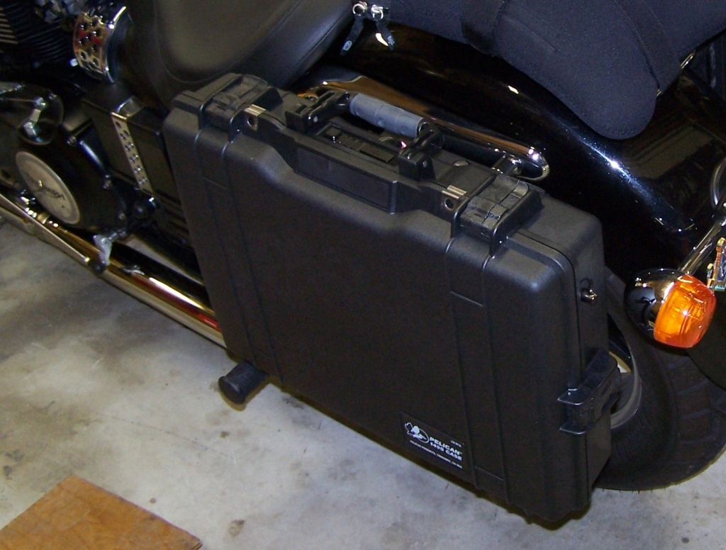

Here's my America with 'em...
