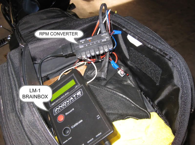

LM-1 brain box; LC-1 kit; RPM kit with Inductive Clamp.

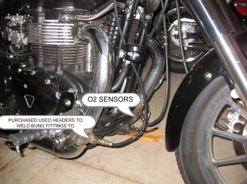

I welded bungs on a used set of headers and installed an O2 sensor in each.

Below are some pic’s of the setup.
