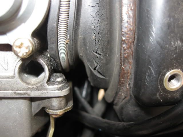

I found this today on my bike... heavy cracking on the carb intake rubbers (the rubber boots connecting carbs to airbox). The cracks don't go right through but are deep and a true concern. I filled them with polyurethane caulking as a temporary measure until I get replacements.

WOW! Good catch. How old is your bike?

She's an '03. Stored in a Garage until '09 with only 2000 km when I bought 'er.

Goin to go look right now,they look like siht Keith,perhaps they dried right out sittin fer so long.

I got an 07 and was playing in my carbs just last week. Noticed the exact smae thing. But not as bad as yours tho.

Mine started doin that but it started comin apart right at the box

Yup, noticed that on my 07 TBA after about the first 2000 miles! What a piece of garbage! That's what prompted me to rip out the airbox and put on pod filters.

my original rubbers from 2001(like those above) looks perfect but I replaced them with new ones for better fit with clamps
