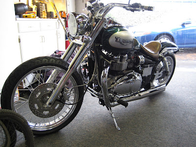

took another 1" out of the front. Scrapped the speedo(who needs a speedo..or a rear view mirror for that matter)and testing out BC's new turn signal brackets... [url=  web page[/url] [url=  ]web page[/url] [url=  ]web page[/url]

Where did you get that front wheel and what size is it . I love the look of your bike

Are those signals from bc also and what did you have to do to get them to bolt in the fender strut. thanks

The front wheel is a 21x4" custom from built by MC tire works, a motorcycle wheel business, in Lomita, Ca. 'Spokes' drilled the raw wheel, chromed it and laced the stainless spokes to my hub. The tire is a Metzeler ME880 120/70-21 inch tire. The front turn signals, as well as the rear, are Kuryakyn halogen silver bullets. The BC light mounts attach to under the triple tree. I had to modify the light mounting whole because the Kuryakyns mounting bolt was a little too big.

Looks really good. Are you using the rear turn signals as the brake light?

Yes. Brake(flash, flash, on), turn, and running.

How much does a front wheel set up like that cost?
I paid $575 and that included the tire. The wheel did come from Buchanan. I got a break on the labor. I chromed the disk and brake calipers on my dime. And polished the hub myself.

575 is cheaper then i thought now i have to find an america hub for my speedmaster. Any one know where i can pic one up.

Hi John..the bars do look taller now that the speedo is gone. But they sit perfect. They have a 6" rise and any shorter would strain my shoulders AND risk hitting the tank when turning. I have been contemplating a new headlight. I don't want to go HD on this thing. I have tried to retain the Triumph bobbed look. The headlight gives it that Triumph-ish look.

Nice bike, What Tbars are those and were that a direct fit or was there some modding.

Wasnt the bike kinda tipped back before with that larger front wheel? And thats what made you lower the front down?
Im pretty sure I remember thinking that the tire was cool but it needed to be lowered to level it out. Do you got the old pic?

Those are Baron's drag bars. They are a direct bolt on. I had to modify the holes for the internal wiring down at the triple tree and both sides for the grips. Basically just elongating them. I can get the part# if you want.
It took some time to level out the bike because I also added the 200 Dunlop in the rear. The front of the bike only sat 1 inch taller in the front before I cut down the spacer just last week. It wasn't that noticable but it bugged me. The progressive front fork springs make up for the dampening and the shortened spacer. The bike is smooth..not stock smooth..but suprisingly smooth since the suspension sits 2" lower than stock. Now the spring rate is almost exact from front to rear.

What kind of Pipes are those and do you like them? I think i just bought a set of those off ebay, really just bought the headers, the pipes came with them

They look like Bubs. I got 'em. and I like 'em. YRMV Uncle Charlie

Yep Bubs. And yes..they scrape when I turn hard AND hit a big dip(not a dummy..but a deviation in the road). Can't see the marks as they are on the inside facing the center line of the bike. Ask Dwight..I think he tattoo'd them once or twice! Great pipes for the Triumph though. Now if I could just figure out how to mount and fabricate this set of Scrambler pipes I have sitting around.....next step in the continuing evolving money pit....
