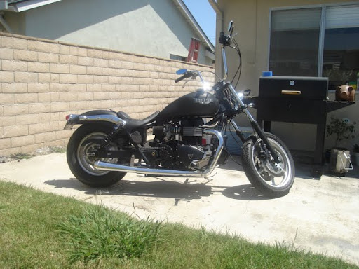

SDKimo #374427 05/29/2010 5:47 PM
Posts: 853
SDKimo Offline OP
Posts: 853
Finally Done !!!!

Re: My Project
Soren #374429 05/30/2010 12:50 AM
I like it! More/better pictures, please.

A few more
Re: My Project
SDKimo #374431 05/31/2010 6:38 PM
Joined: Feb 2010
Posts: 237
Joined: Feb 2010
Posts: 237
wow great job .. love the many details.. well done !!

Looks Good! I am still not sure about riding without a front fender but I like the look that it gives the bike!
