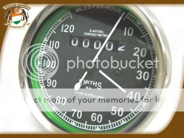

Are our stock speedo's a 2 to 1 drive ratio? I found a great re-pop of the classic Smith's speedometer for my build that I'm praying will work.
[image][/image]
Wait a minute... I think I just partially answered my own question. As long as I mount a 2 to 1 speedo drive on my front axle, it'll work, right?

Our speedo's are 2240:60 same as early Jap bikes
I hope that helps
