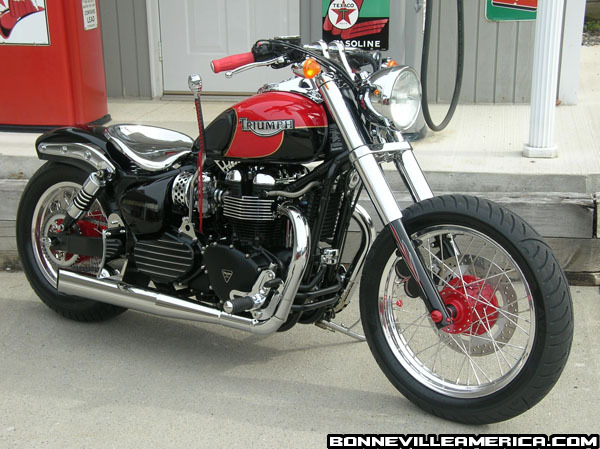

A PA guy build a really nicely finished bobber-style bike with tractor seat & a really cool Jockey shift. He bought a complete forward control linkage set and used that to run it over to the left side. A lot of effort, but it worked flawlessly. This might be the guy referenced earlier. I have pix on my home machine from the Butlers Orchard Brit Show a few years back, will have to dig them up.

That lower picture still shows the hand clutch cable in place so I'm guessing he didn't include a foot clutch as part of the jockey shift mod. That would explain the right side shift placement and the need for a complex linkage. I should think that it wouldn't be much of a job to do a complete left side set-up moving the clutch to the foot and grafting a hand shifter on the shift pawl at the transmission; it's not like you'd have to make any internal mods.

I can't see if he has a hand clutch lever or not, maybe I need some new glasses!  and with a right side tank shifter(least its closer to a tank shifter than a jockey shifter), must be tough giving it gas and shifting! I have seen some shifters, jockey and tall tank like with the clutch lever attatched to shifter!(must suck if in gear at a stop tho!  ) I want a foot operrated cable clutch pedal and a short left jockey style lever. that way I still can control throttle with right hand and left hand is free to do whatever when at a stop light.  I also noticed in pic that there is a red line (electrical wires?) going up to shifter grip. Or is that some type of cable clutch hook up?

Look a little closer and you'll see that it's just girly fringe hanging off the shifter. Here's a place to start hunting answers: http://www.steelthundercc.com/shift_n_jockey_control.html
Yeah, that's why I said it was an either-or situation.

I saw a jockey shift done with the clutch lever on the shifter, always liked that idea. A foot clutch would be easy to do on our bikes. I had some better shots of Tommy's bike showing the linkage better but can't find them.

Is this the sought of thing your looking for? This bike is owned by a guy who belongs to a chopper site I'm a member of, I hope he doesn't mind me showing it off
