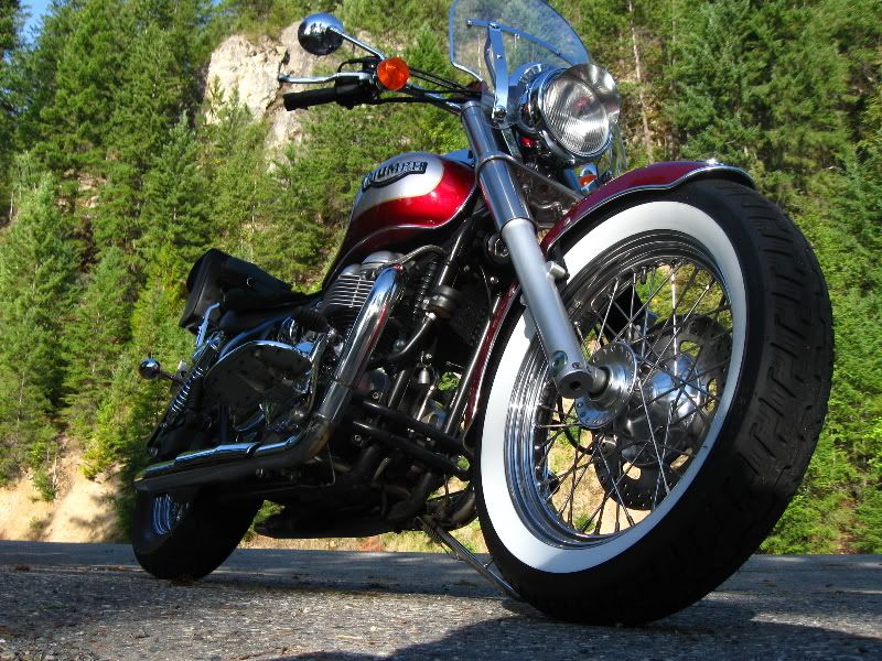

Went with a Kenda 130/90-18. I removed the mud guard, ran dual brake lines from the master cylinder, lowered the forks to compensate for the shorter rear shocks and taller front tire and made a couple of brackets to keep the hoses from rubbing on the tire. The tripple clamp and axle seem to have no problem keeping the wheel stable, even at speeds over 80mph.
It was a project, but well worth it IMHO.

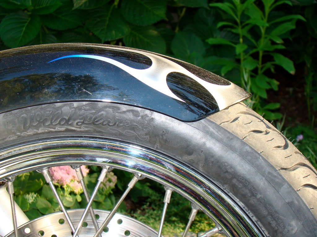

DunnSpeed: How much clearance do you have between the tire and fender?
From this POV it looks like a quarter of an inch.

Here's a side view. Don't have a pic closer up right now.
The clearance is 5/16".

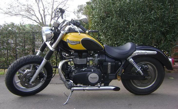

130/70 R18 front

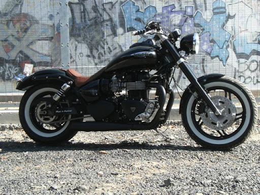

I agree, the 120/90 makes the speedo more accurate than the stock size tire does. Not to say the 130 doesn't, I have no experience with that size tire. I love the fatty up front though, it looks like it should have been there the whole time.
As long as we're posting pics of our bikes....

120/90 up front here
Well, that's one way to make the newer gas tank look cool.
